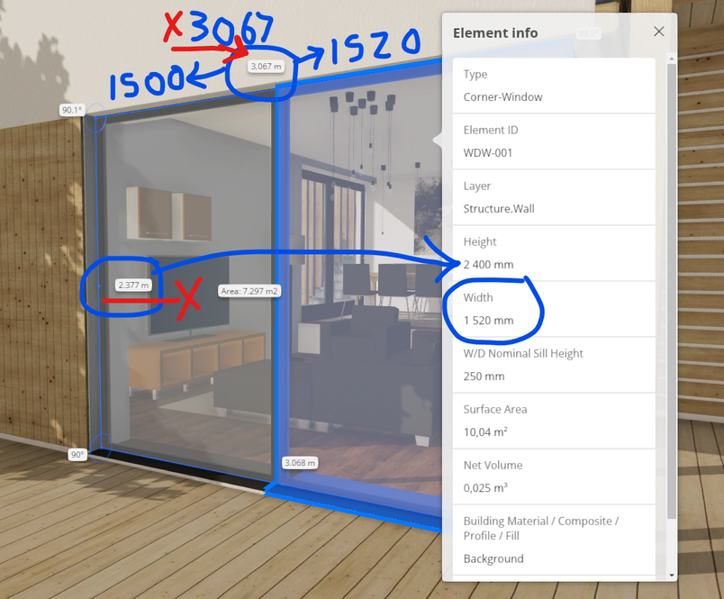

Hello, I picked up an error in the BIMx Desktop App v2025.6760 (Windows 11).
The Measure function is not snapping to element nodes as it does in my iPhone & iPad Apps v2025.6742.
I have just tested this in BIMx on the web version in this BIMx Sample Model and the measure tool is also here not snapping to element nodes, same problem as the desktop app.

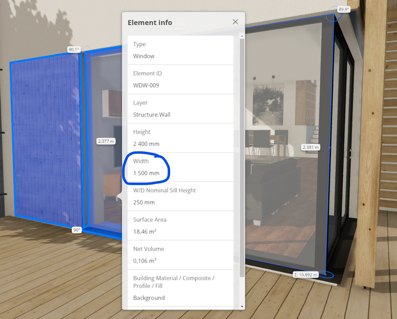

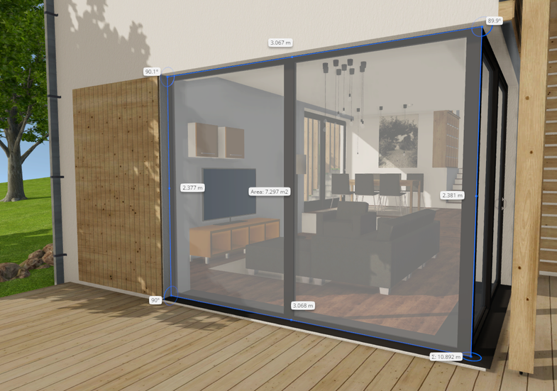

For reference, here are some screenshots trying to take precise measurements in the Desktop app in the BIMx sample of AC28.
If I check the window measurements in the Element Info... you can see how the BIMx Measure tool is not getting it right, because it is not snapping to the element nodes.
(it does find the element surfaces though, but this does not measure correctly as it is not nearly accurate enough as intended / supposed to)
Can you please check on this urgently to fix this asap & let us know what we should do?
