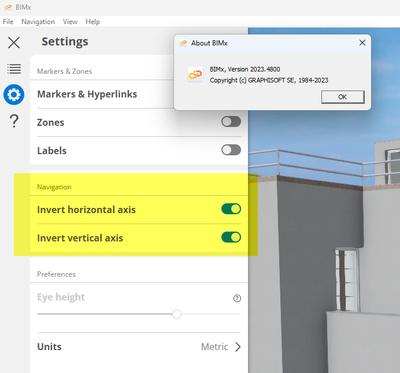

I am not sure I have the latest version from the app store, but does the invert horizontal/vertical axis options have any affect?

Thanks Barry but this does not help. There are time that I make a change in the 3DConnexion settings to revers motions and it seems to work for a second or two but then reverts back to being reversed.
