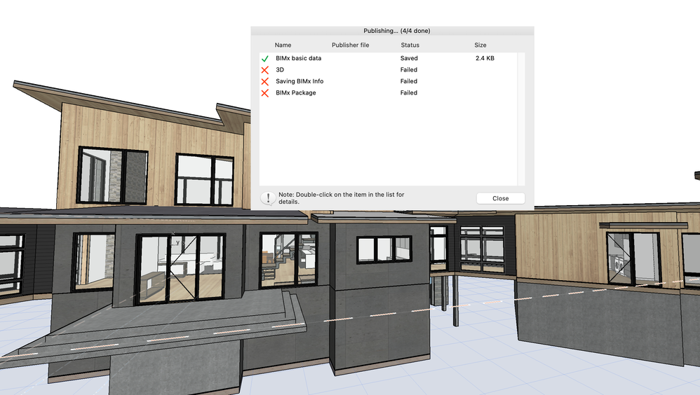

Archicad 26 Bimx Failure
I am trying to create a Bimx, I've never had an issue before, but I have one file that will NOT publish a Bimx. I don't know what to do as I was able to create one on the same file a couple of weeks ago. Help! I attached a screenshot of what I am getting when trying to publish.  

Dear AandR,
Thank you for sharing your experience with us!
Please take a look at this issue:
https://community.graphisoft.com/t5/Document-Visualize-forum/Archicad-26-Fails-to-generate-views-whe...
Is it possible that you have the same BBQ object in your project?
In case it is a different issue please contact BIMx's technical support at [email protected] and send the problematic project file in .pla format for further investigation.

AandR
Yes! Thank you for finding the solution for me! It said it generated the Bimx
But now when opening the Bimx it said that the 3D document is missing. What do I do now?

Dear AandR,
I am happy to hear that the information helped.
Regarding the missing 3D model: please contact BIMx's technical support at [email protected] and send a screenshot of what you see in the BIMx application.

Class5Design
HAHAHA
I was the BBQ in my model that was causing the mayhem!!
