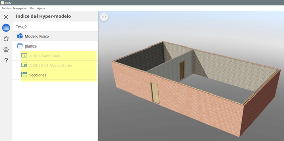

I've tried publishing several different projects in BIMx locally to a folder with a simple path, and I'm having the same problem with all of them: the plans aren't saved—only the 3D models.
I'm attaching a simple .pla file to see if anyone please could help me (ZIP ).
For the record, I've been publishing with BIMx for years with no problems, so I think I kind of know the procedure.
I have Archicad 29.2.1 (5101) INT FULL and SPA FULL installed. Same issue.
Thank you.

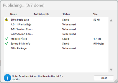

Double click the yellow warning triangle to see what it says.
Don't use special characters in the file name - keep them simple - hyphens are OK but avoid periods.

Hi @Barry Kelly
The yellow warning was because no preview image had been attached. Anyway, I've done that—I've even avoided using any special characters in the file names, plans, and views—but the problem still hasn't been resolved.

Hi
Open the PLA file, export to BIMx, and everything is correct. AC 29.2.1 SPA
The sections are not on a layout, which is why the hyperlinks do not work.
