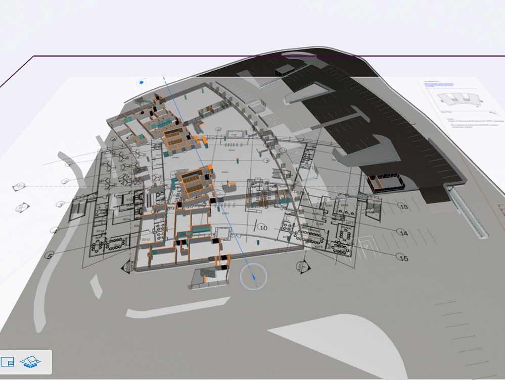

We have saved views with a 90 degree rotation - when saving the hypermodel the plans are 90degrees out of alignment with the 3d model - suggestions to fix?

I've got the same problem either with custom view orientation or custom angle drawing (viewport)
Any advices apart from rotating the whole model?
We have recently fixed a really similar issue in Hotfix 4 (build 5005) for ArchiCAD 17. Do you have this patch installed?
