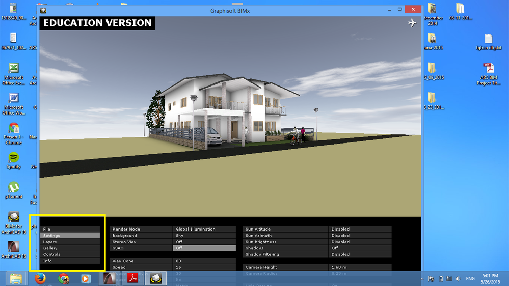

Hello when I published my model to Bimx and opened it, the global illumination is not available and how can i export it to exe file?
Do you mean in 'Settings' > 'Render Mode' that Global Illumination is greyed out?
This is normal if you have not 'Initialized' the Global Illumination.
You can do this from the 'Global illumination' section where you will see the 'Initialize' button.
If you can't Initialize GI then I am not sure why not.
Sorry can't do a screen grab of BIMx.

Yep. There is no Global illumination, how can I activate GI in exporting bImx model?
So just to confirm you don't see this in the menu (see screen shot below taken from the manual).
Is it greyed out or just not there?
There is no global illuminationmm setting where can i find it?
I need also to save it to .exe file in the file button -> export but cant find it
Maybe the Educational version is different to the full version but it is showing that the render mode is already set to Global Illumination.
This is different to what I see in the commercial version.
Can any one with EDU version confirm there is no GI options and render mode is already set to GI?
There is no .EXE file version for BIMx.
