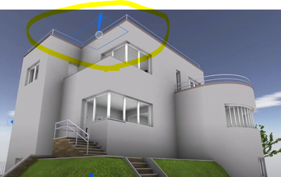

Hi, When i upload my model to BIMx I don't see any interactive markers. Does anybody know what is the reason? How to prepare model to be able to use these markers. Thanks.
Solved! Go to Solution.

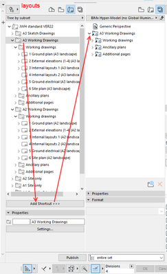

2023-04-03 04:23 PM
You don't want just views in your publisher set.
You want the layout pages.
It is the layout pages that have the linked markers.
I use the 'Add Shortcut' button in the Organiser to add the layout folder I want to the BIMx Hyperlink publisher set.
That way if I change the layouts, I know the publisher set will be updated automatically.

I have this option turned on. You said I need to import 3D model and PDFs? Or you mean "views" made in ArchiCAD, which I choose in Publisher? Do i have to connect model with views or change something in ArchiCAD to make it work? I use student version, but I don't know if it changes anything in terms using full options of that programme.

2023-04-03 04:54 PM
Thanks a lot for your help. Now it finally works as it should be. It was about changing element to publish in Publisher Set. They really needs to be Layouts, not only Views.
