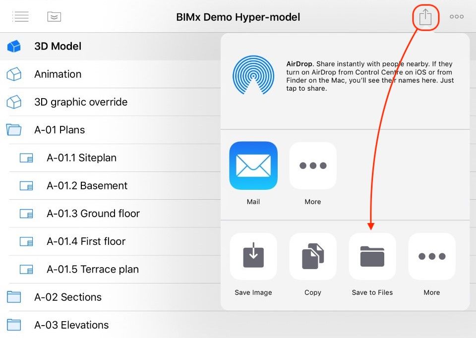

1. Share your models locally on your mobile device:
- Open your previous BIMx and load a Hyper-model
- Tap on the Share button on the upper right corner
- Save to Files on your device storage (see the image below)
- Open your new BIMx application
- Tap on the "+" sign on the upper left corner
- Browse and import your Hyper-model
- After migrating all your Hyper-models, the previous BIMx application can be deleted

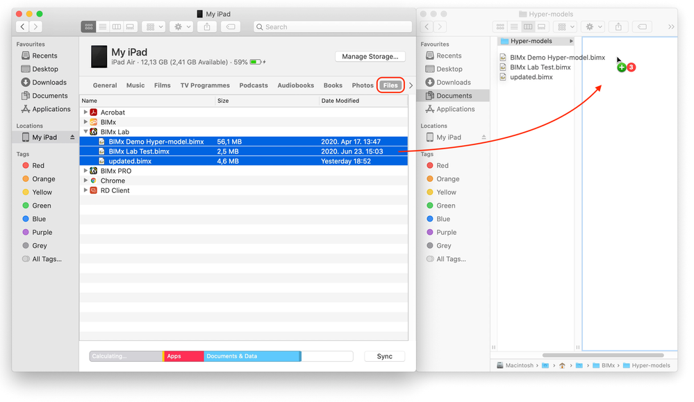

2. Use Finder on macOS Catalina:
- Connect your mobile device to a computer via cable
- Select your device and open its storage
- Click on Files
- Select all the content of your previous BIMx application's folder
- Drag and Drop to the desired location on your computer (see the image below)
- After all the files have been copied to the computer, your previous BIMx application can be deleted from the device
- Drag and Drop all your Hyper-models from the computer to your new BIMx application on the device

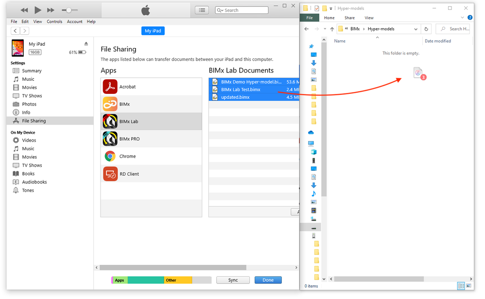

3. Transfer your Hyper-models via iTunes
- Launch iTunes on your computer
- Click on your device icon in the left column in iTunes
- Choose File Sharing in the menu
- Select all the content of your previous BIMx app's Documents
- Drag your Hyper-models and Drop them in the selected location in File Explorer or Finder (see the image below)
- Drag and Drop all your Hyper-models, now to your new BIMx app's Documents
