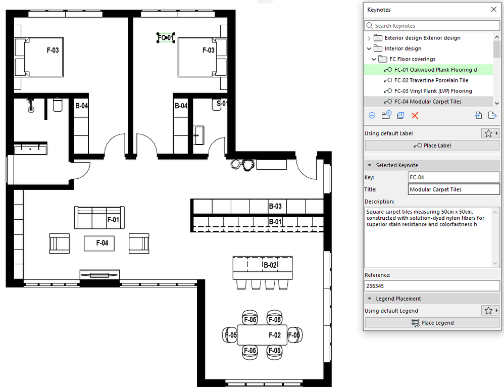

The Keynote palette in use:
The Keynote Legend is a detailed list defining what each number or code represents.
The Keynote Legend placed on layout:
Example of Keynote Use
Floor Plan:
In a floor plan, different walls, floor finishes, and other elements may be identified with keynote numbers. For example, a wall might be marked with the code "K1."
Keynote Legend:
In the associated keynote legend, "K1" might have the following description:
"K1: Interior wall - drywall, smooth finish, white paint"
