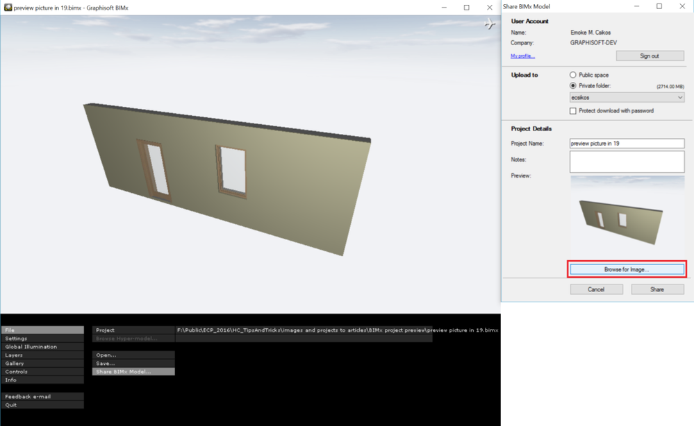

For BIMx 3D only models the project preview is always the view from which the BIMx file was exported (File > Save as > Save as .bimx). You can later change this picture if you upload the model to the BIMx Model Transfer Site.
