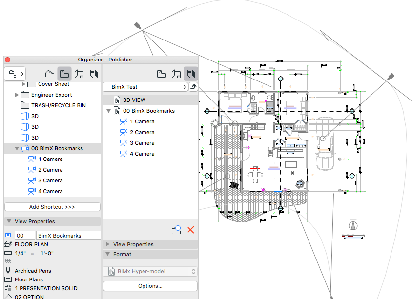

The saved "views" have to be created with the camera tool.
The cameras are created in the "3D" folder of the project map.
Save the cameras (individual or in a path) to the view map.
In publisher, add the saved camera "views" to your BimX publisher set.
Here is some info.... but it may be more confusing.
Add-camera-views-to-the-bimx-model

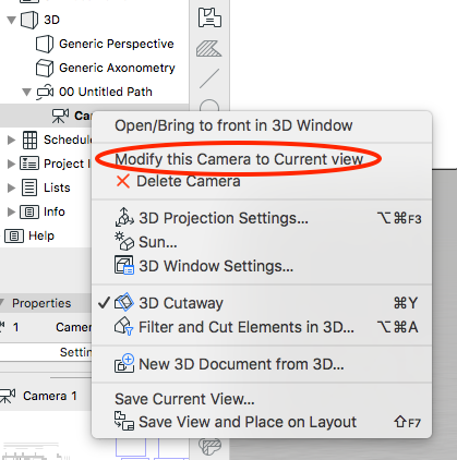

You can still do this with cameras.
First place the camera.
Open the camera's viewpoint by dbl.clicking the camera in the project map.
Orbit the view, adjust the sun, layers, etc.
Right click the camera in the project map and
"Modify this camera to current view".
Save it as a view.
I don't know about file size.

You are saving a model per camera thus the increased file size. You need a single camera path with multiple views in that single path. Find your view in 3d. Then go to the menu bar click view then 3d navigation extras, the add camera to path. I have like ten cameras per bimx with no where near that much increase in file size
You don't need to publish the camera with the bimx just the 3d model. If the Camera path is on then it will be part of the bimx
