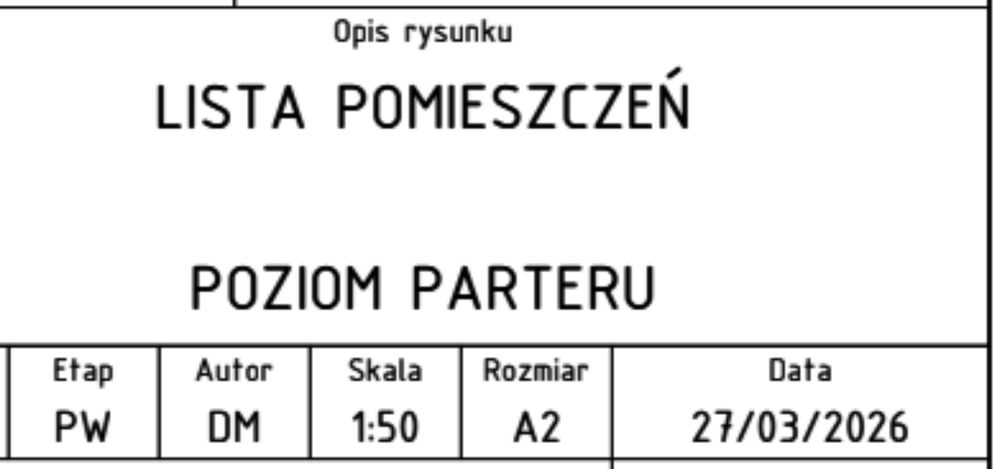

How this quality can be even satisfying anyone? Smallest font from this title block is finally 2,5mm (scaled down by 0,5 instead by upscaling 1:100 part model).
It's a joke, isn't it?
