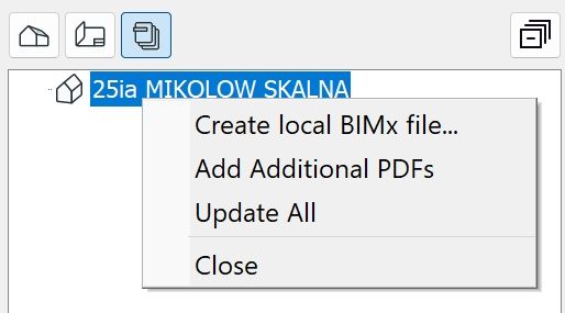

@Benjamin Dani I work with DDScad and overall adding additional PDFs may be option. When it comes to interaction with site, especially on small / medium tasks, possibility to giving access to freshest set of drawing is essential. There is always a laptop / PC onsite. So uncompressed PDF's are essential.
In general you advertised in ~2022 Archicad tight workflow and tight integration with BIMx, content from marketing videos is still impossible to achieve. Releasing MEP hyper model without possibility to cut / disable / hide certain walls makes it unusable in practice. There is also no connection between floorplans and models. I can be OK with it but after all even essential feature like batch transferring of PDFs to site is also not that well done. There is a publisher set feature, designed especially to BIMx integration (there is no other option for batch exporting of PDFs!) and it's killed by degrading of quality.

Guys, please post a wish on the Wishlist. That is the only way to find out how much support this wish has, and then that can be forwarded to Graphisoft for consideraton:
https://community.graphisoft.com/t5/Wishlist/idb-p/wishlist
