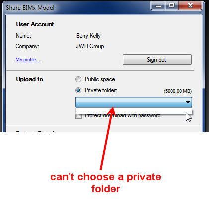

Just tried straight BIMx upload from 17 and that goes nowhere at all.
Doesn't even let me choose a private folder.

If you have upload issues please send an e-mail to bimx [at] graphisoft [dot] com with your registered BIMx email address and your WIBU/CodeMeter key number(s). Please also state that at which step do you get stuck and which error message appears? There might be an issue with some of your account settings what we would like to check out.
Barry: When you try to choose a Private folder, have you created one already at the BIMx Transfer Site? In my experience you can only choose from your already existing Private folders and can't create a new one during upload.

Hi Csaba,
I can now see the "Root" folder when I try to publish so I am not sure what that problem was.
The strange thing for me is I can't publish from my work PC but I can from my laptop using exactly the same WIBU key.
