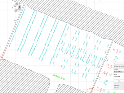

Iām running into an issue when working with a consultantās 3D DWG in ArchiCAD. Hereās the situation:
I attach the DWG as an Xref, including all layers.
Most layers are visible, but elements drawn in 3D by the consultant do not appear, neither in plan or 3D/section (see screenshot).

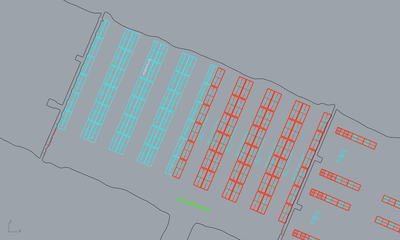

If I import the same DWG into Rhino, all elementsāincluding the 3D onesāare visible in both plan and 3D views (see screenshot.

Rhino:
ArchiCAD:

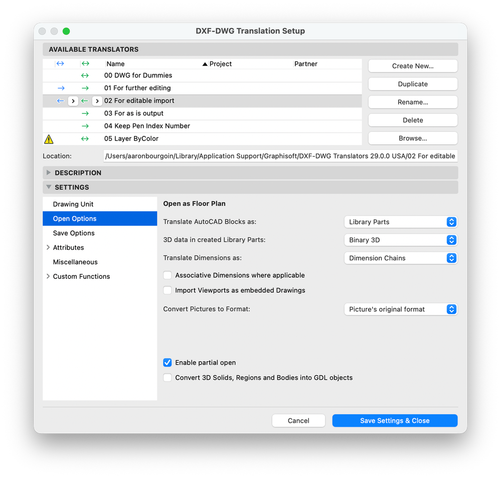

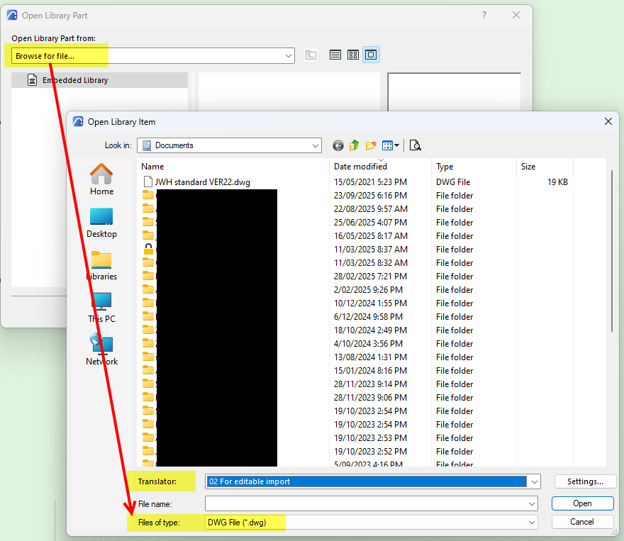

a week ago
Yes, Open Object (my bad). Have a look at the settings for the translator you're using. See screenshot. I've selected Binary as the GDL script would be mostly useless.

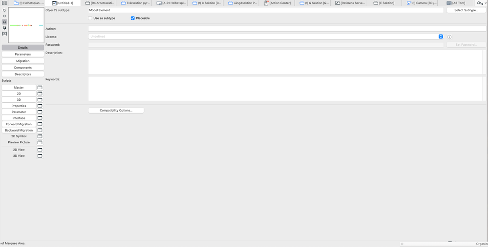

Hm, I used the Open Object dialog, but to no luck. However, I can't find anywhere where to choose a translator in this dialog. What am I missing here? Google is no help, unfortunately.
Monday
it shows up in the dialog where you choose the format DWG. bottom right of the file open dialog? smae place as it does when you use the File open command.

Tuesday
FYI: Whenever you cannot explicitly choose a DWG/DXF Translator, for example, when you place a DWG/DXF with the Drawing tool, Archicad will use the default Translator for Import.
You can go to the DXF-DWG Translation Setup Dialog and check which one it is.
Usually, it is the "02 For editable import" Translator. The little blue left-pointing arrow before its name is that indication for that. In the green arrow column, you can specify if a Translator is used for Export, Import, or Both, and when a Translator is used for Import, you can then use the blue arrow column to specify import Translator should be the default one.
