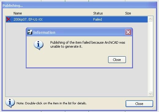

As mentioned in another thread AC 10.815 is sometimes unable to publish and or / save to DWG.
DESCRIPTION
I have a number of 10.0 files in which publishing to DWG will fail on some stories and sections/elevations.
Some stories/sections can be publish, others can't. I have even tried to delete all entities on a story which couldn't be published to DWG. Put even then I am unable to save or publish too DWG. And yes, I have tried different translators …. with no luck.
Saving a story / floor plan to DWG will give me a "Cannot write output file" error message. Publishing the same story will mark the file / item with status "Failed". Double clicking the list item gives me a nondescriptive error message: "Publishing of the item failed because ArchiCAD was unable to generate it."
This has happened to multiple ArchiCAD 10.0 projects / files. There is no clear pattern. I am able to publish some stories, and some not. Yesterday suddenly I was unable to publish story 1 in an ongoing project. This story has been published many times before, but not anymore now. (Deleting all entities will not help. Deleting all entities, saving, closing file, closing ArchiCAD, reopening Archicad, reopening the file and publish will not help.)

No, can't save/publish from a layout.
.... Update
I have to correct / clarify my self.
I am able to publish a DWG file (of problematic stories) by publishing a layout to DWG.
But there is a big problem: There are absolutely no entities in model space, and the drawing is inserted in paper space as a single block. Exploding the block will reveal that all entities are on layer 0. Useless.
Translator options
Paper Space with Full Drawings content + Single DXF/DWG-file
and
Paper Space with Full Drawings content + Linked Xref drawings
... both create the same useless result.
Using translator options
Models Space as Flattened Drawing
gives: "Publishing of the item failed because ArchiCAD was unable to generate it." error message ....

I had similar problem wit publishing to DWG. After slowly deleting objects from a storey I found out a strange thing, that the problems were on a storey below the "problematic" storey. And the problem was in Window/door marker. After switching markers off, or change them to our old markers it started to work. Dont know if it helps in your case but, I saved to AC9 and publish from there.

This may not have anything to do with the issue but are the drawings on the layouts you are trying to publish set to Automatic Update?
I was getting the very same error message (and useless explanation) when trying to publish both DWG and PDF. I thought it may have been caused by the publishing action timing-out as AC was taking too long to do the whole BG AC update thing, so I switched them all to Manual Update and the problem went away ..

I have been tracking down the problem to one door placed 2 stories above the problematic story.
Deleting the door makes saving / publishing to DWG possible (2 stories below).
Even more important; changing door anchor from "Sill to Story3" = -175 mm to "Sill to Story3" = 0 mm or to "Sill to Wall base" = 0 mm, also makes saving/publishing possible. (Wall bottom is 175 mm below Story 3).
Some self-healing occurs, ... sometimes. After changing back to using "Sill to Story3" / - 175 mm it is sometimes still possible to save !!! (I have tried this multiple times.)
Lesson learnt: using anchor point "Sill to storyN" can introduce errors in the project file.
There is a bug her. GS please investigate.
PS
It is no problem to save/publish the story in which the door is placed.
The wall is shown on "Own Story Only" and "Symbolic Cut"
DS
In another project file I have tracked down the error to windows with anchor point below the wall.
No problem for ArchiCAD unless you try to save to DWG (the story below) …
Lesson learnt: don't put doors / windows below wall bottom until AC 10 is fixed.
