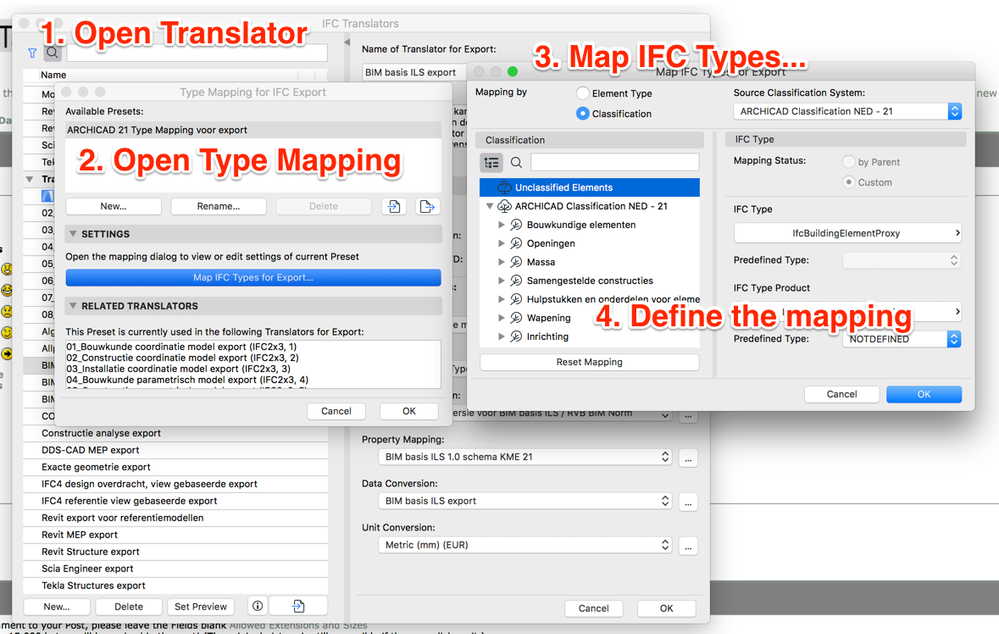

AC 20 to AC 21 : Where is IFC Scheme Setup?
Hello -
Looking high/low for where the IFC Scheme Setup went to from AC 20 to AC 21, with no success.
Any help would be appreciated!
20 REPLIES 20
stefan
Check your Translators and more specifically the Type Mapping. Maybe load one from a default AC21 template which is properly setup?
You can then make that translator "LIVE" so what you see in ARCHICAD is what your model will send out.

I tried that with no results. The existing object keep their IFCBuildingProxy (as I expected since AC has no way of knowing which is what).
If I copy paste to or from an working file the IFCBuildingProxy stays the same. Object mapped correctly in another file paste as proxy. Objects mapped as proxy in broken file paste as proxy in new file.
I do get this message, see attached file. When I said re-mapping I was thinking of the "Mapping rules in order of priority" option. I don't know how to use that for now.
arch. ernest atanasiu
AC 10-29 INT/GER/FR on Win 10/ Win 11
stefan
In AC21, the link between an element and a type can be steered by the Classification. Older files automatically create a default ARCHICAD classification. They are by default, IIRC, mapped to an IFC class.
But the Translator can override this completely with a custom "Type Mapping", which you can base on ARCHICAD elements (e.g. Wall becomes IfcWall, Slab becomes IfcSlab etc...).

Thank you Stefan
You saved the day, that's exactly what I was looking for!
Only thing that remains is to select all objects and classify them but this is easy.

Solution
This is the answer to the original question of where is the IFC Scheme Setup Dialog.
So this Dialog in not available from the menu any more.
You have to go to the IFC Translators Dialog. In the Dialog, select a Translator for Export on the list on the left. Then click the "..." button of the Property Mapping field, and in the upcoming Dialog click the "Map IFC Properties for Export" button.
It will take you to the Dialog previously known as the IFC Scheme Setup Dialog where you can create new custom IFC Properties and mapping rules to any IFC Properties.
