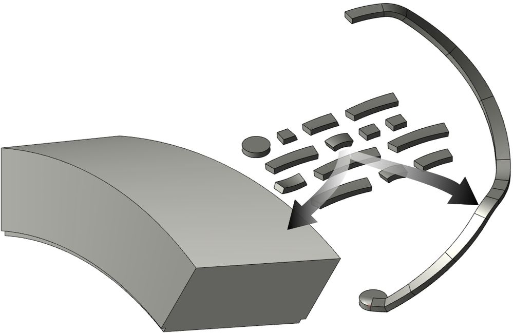

mball wrote:I been through a similar process with a customer using OBJECTiVE. They needed to model a handrail following a non-trivial path for export to CNC (see attached image). The key factors in using OBJECTiVE were the tools for precisely fashioning each component, and a setting in each object to control the surface tolerances. The tolerances can be dynamically modified on individual parts to fine-tune the finished result.
the curves are segmenting to varying degrees. This is something I would like to avoid if possible, or at least have some control over the number of segments the curves are generating. Has anyone had success in transferring 3d geometry to a CNC router
