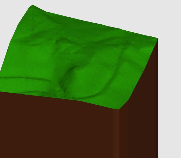

Fabrizio,You are right!
I was able to reduce the original file down to size, at which point ArchiTerra was able to import and convert the data into points!
I tried that several times earlier and the file was allways too large.
I have replied to you privatelyhalf hour ago, so I will post a copy of my earlier letter here:
Fabrizio,
I was able to create the Site model by importing the DXF file into ArchiTerra!
I have attached two renderings of the new model (JPEG Files 1 & 2) and a copy of the 'older' file generated by manually drawing contours and converting them into a terrain. The manual file is so much larger than the other two?
Anyway, I will continue with these files and see how the roads will work with them, perhaps the 2-D information that was part of the tracing process added so much to the file size, and the manual process increases size as well?
Thank you for all your help.
Jacek
I am posting a view of a model sent to you below.
Once again thank you for all your help.
Ciao,
Jacek

Dear Jacek,
let me try to better explain because I suggest to import DXF data by using ArchiTerra instead of using ArchiCAD.
The most of time (so often we could say ALWAYS!) the DXF files contains 3D polylines that describes the contour lines of the terrain.
These polylines are 3D entities that means they contain all the info regarding the level of the contour line
Unfortunately, the most of time, these polylines are made by thousands of little segments: this is often due to the fact that these drawings are the result of bitmap vectorialization/conversion.
This so-high-curve-segmentation isn’t useful at all: these segments are often shorter then 1 cm (now I’m talking of real length!) and, at least topographically speaking (we are talking about terrain not about building!) you don’t need so many data to describe the terrain model.
For these two above arguments I suggest to import DXF file by using ArchiTerra because, as I wrote you before:
1. ArchiTerra will import the contour lines z level too (it preserves all the 3D data)
2. it provides the user with the filter function that enable him to simplify these polyline (for example, by settings the filter to 1 meter often you can halve the number of 3D polyline points without any sensible difference in the 3D morphology)
Of course, what is really IMPORTANT is the layer handling:
Pay attention, that ArchiTerra will import/convert all the data on the selected layers so it’s very important (let me say crucial!) that you import the data only from those layers which includes relevant data (points and contour lines), and, as you surely realized, this can be obtained by using the proper ArchiTerra Import dialog window.
Another suggestion is to discharge the conversion of the polyline segments too and import only the points coordinates (that means you have to enable only the first check-box, near the layer names, in the ArchiTerra DXF import dialog window). Once again, usually these polylines contains so much nodes (and usually equally distributed along them) that you won’t need also the constraint between these points: this will speed up the import process and will simplify the data (so the ArchiCAD elaboration will be also speed up).
So, unfortunately, you made a mistake from the beginning because you got a so heavy document and you did it MANUALLY!
But don’t worry, next time you will remember this advise and you will simplify your job.
BTW, I got your DXF but you forgot to communicate me its unit!
Please, send me an e-mail to communicate me the correspondence between 1 DXF unit and its real size.
