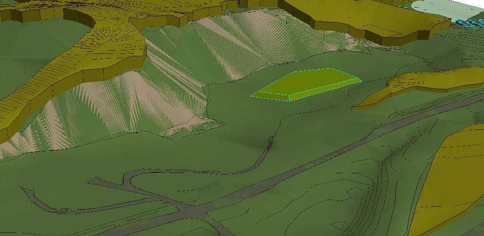

Firstly I want to thank Fabrizio from Cigraph for his swift and helpful answer for my other question. It's great to know that the product is supported so well.
So, Fabrizio, I have another problem for you. I want to calculate the cuts and fills of a plateau object I have placed on my terrain. I follow the procedure described in the user manual like this.
1. I select the terrain mesh.
2. I press calculate in the arciterra toolbox to update data for calculation.
3. When i look for the "ArchiTerra 30" -component list in my project, i cannot find it. I have two other lists: "Base (Architerra_DB)" and "Default (ArchiTerra_DB)". So I decide to use these.
Now i run into troubles:
When I select the mesh and list components, the result is an empty list. I suppose this would be ok, because there is no property objects bound to the mesh itself, and I think that calculation needs to list the OBJECTS created by ArchiTerra.
When I try to list a single plateau, the result is an empty list.
When i try to list everything (I do this by selecting nothing in the plan view and double clicking on the Base(Architerra_DB)-list), the result is an error message. It's in finnish, but the contents of the message suggest that 3D_document detector.gsm -object has incompatable variable types in master script line 4.
I'm a novice in GDL-coding, but to me this seems to mean that the APPLICATION_QUERY in 3D_Document detector doesn't get a string type result in the variable "type".
I know this is very hard to debug without the actual file, but could someone suggest what is going on, and how could i fix things and produce calculation lists.
I would also like to note that my terrain is rather complex, and i've used several painter and building objects. Only one plateau, though.
