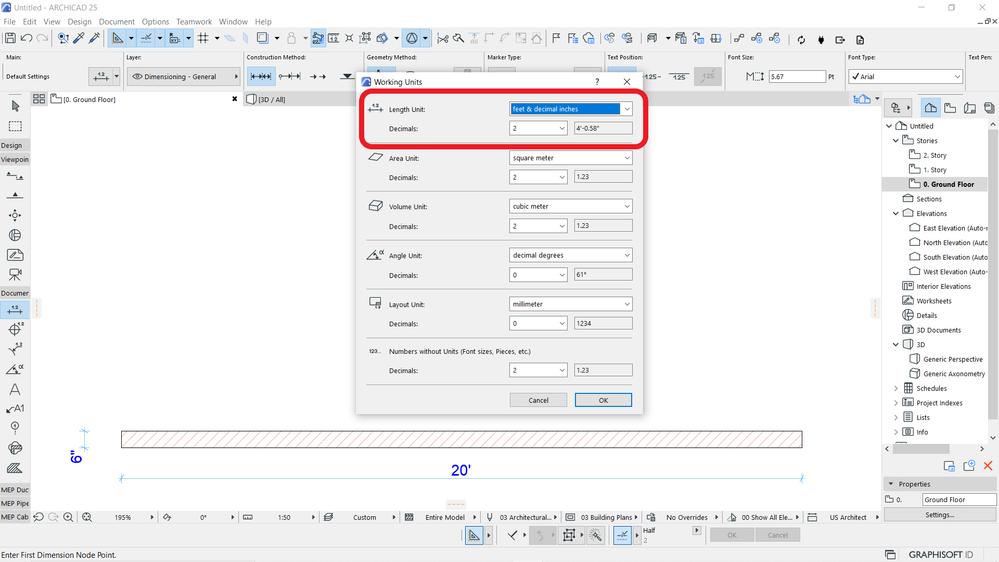

Step 1 - Archicad Units setup

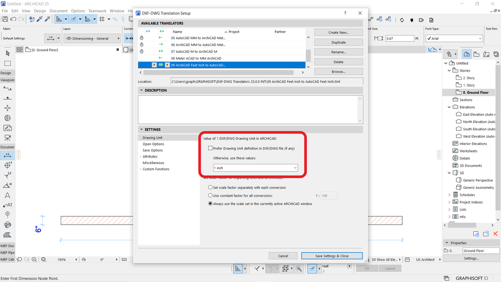

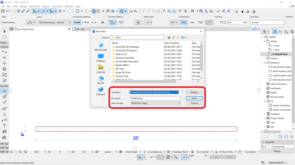

Step 3 - Export DWG with required Translator

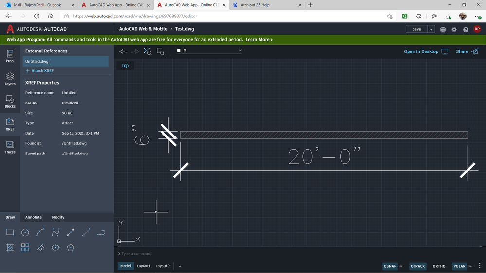

Step 4 - Start new file in AutoCAD with Imperial Units Template ( I am using web base App)2021-09-15 (3).png
Step 5 - Use Xref to insert your Archicad DWG file
Check the inserted drawing for its unit length, it should be in Feet Inch and not only Inch

Autocad default unit system (for Imperial/Architectural) is inches that means that if you type "6" it will presume that is 6" instead of 6'-0". The units from the exported file (from AC) will always show "Decimal" in Autocad unless you use add a "Template DWG" in the Translator (under "Save as") that already has the units set to Architectural.
