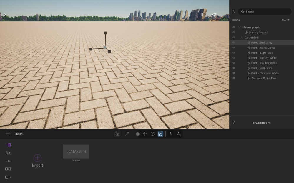

I tried importing the Archicad file into twinmotion via datasmith file and also directly synchronizing with direct link, but the model does not appear after importing it. There is a layer of the file that appears with the materials, but no matter how much i zoom in or try to scale it up, nothing is there. I also tried importing it with different export settings in Archicad, but nothing seems to work... I also tried saving it as Wavefront file and when I look at the file on my desktop, you can see the structure, but once I import it, again, there is nothing there. I have never had this problem before and I am going crazy, trying to figure what I am doing wrong.
If someone knows how to solve this, please help me.
Im attaching screenshots of twinmotion after importing it, a Wavefront file on my desktop and an Archicad screenshot.

I think it might just be that it is not in the default Twinmotion viewing area.
I am sure there is a way to do something like a zoom to model, but I don't use it enough to remember the exact command.

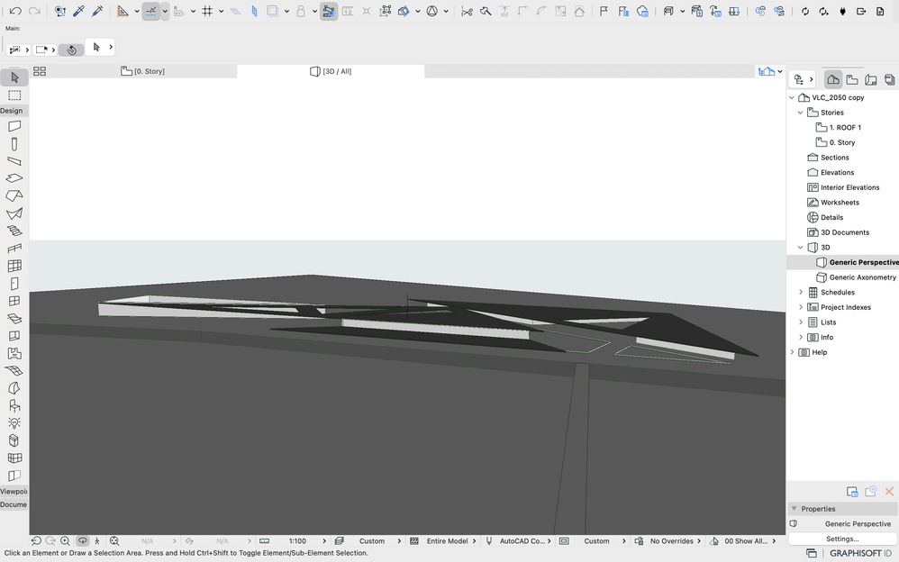

But I think it has something to do with visibility in Archicad... I merged 2 files in Archicad and the one I am trying to import in twinmotion (the screenshot one)  is also invisible in Archicad 3d perspective of the merged Archicad files, even though, in plan there are walls, slabs... ( and all the layers are turned on.)
Do you maybe know what I am doing wrong in Archicad that it is also invisible in 3d?

With AC 26 and TwinMotion both running and the datasmith palette displayed in the Archicad 3D window, I click Import in Twinmotion to create a new link to Archicad, I click the refresh button on the datasmith palette in Archicad and the model is transferred.  NOTE:  there is no zoom to your model!  It could be anywhere in space, and potentially not even visible.  In the model browser in Twinmotion, the easiest way to find your model is to select an element, right click, and zoom to that element.  Then navigate back out to where you want to be.
