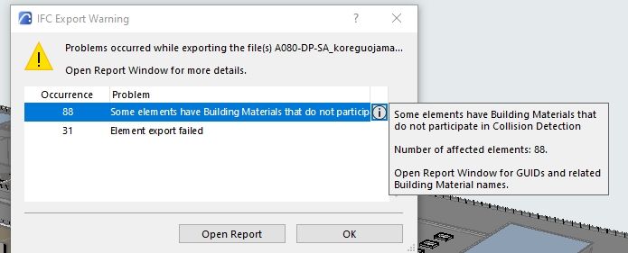

I have a problem exporting material thickness to ifc. The filter is okay - other models are exporting correctly with it, but one of the models export materials without any thickness (I can see materials, but their thickness is 0). Can't find what's wrong. Do you have any ideas how to export them? or any clue what's wrong with the model?
I also get this error when exporting (you can see it in attached file)

About the error message:
maybe you have Building Materials which have their "Partificated in Collision Detection" checkbox unchecked?

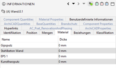

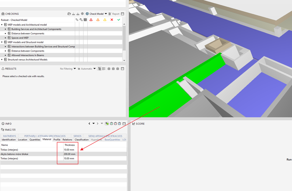

I'll add a bit to Ieva's inquiry: checkbox is checked in all materials, so I guess this should not be a problem. The problem seems to be with IfcCovering (Ceiling, Cladding, Flooring) - it exports the Material tab, but the thickness is still 0mm, where IfcWall is exported normally. I'm adding a couple of printscreens below.
Thank you in advance!
OK, I see, so the geometry is actually correctly exported to IFC (the element has thickness), but the thickness Properties report 0 mm for thickness for some reason.
I would say that this is a bug so I will report this to Graphisoft for investigation.

Dear All,
Thank you very much for sharing this problem! We have consulted it with our developers and it turned out to be a limitation of the IFC Schema and Solibri:
The parametric composite structure can only be preserved in IFC for IfcWall and IfcSlab via IfcMaterialLayerSetUsage. Solibri shows the thickness value from that, if it's present, otherwise it shows 0.
So this is a bug of Solibri (showing 0) and a limitation of the IFC schema (disallowing this structure for other types).
I hope this explains the situation. Please let me know if you have any further questions!

Dear Minh,
Thanks for your provided explanation - this behaviour is still valid till the present day for models generated by AC. Interestingly is that in the provied screenshot above the walls indeed have thickness and it solely seems to be a covering issue whilst I get this problem all the time ...
However, if this is a IFC limitation, why is it then working correctly for some models - even those exported from Revit?
