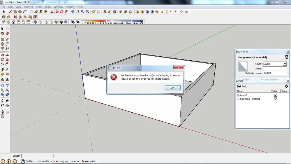

I saved my Archicad file as dwg format and imported it in sketchup.
It work perfectly.
but when I push the render button of Vray for sketchup it always get the error message and my vray dont work.
