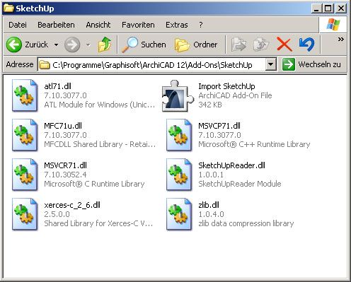

I did installed the plugin but there is no .skp extension in the Archicad 12 Save as 3D window. Take a look:
http://imageshack.us/f/695/60610880.jpg/
Also when I look at the Sketchup folder where the plugin files should be, there is only the Archicad IMPORT plugin, not an export one.
