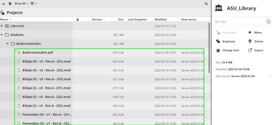

I wonder how You managing more files in BIMcloud server.
I have ~100 files in BIMcloud server, but its very time consuming to delete/move them, there is no option to select multiple items, I need to delete/move every file ONY BY ONE, to manage bigger number of files could be very very time consuming task. Is there way to select multiple items in BIMcloud ?
CTRL + Click not works for me 😞

Multi-selection is available by clicking the checkmark icon on the top left of the list. See it in the BIMcloud Help.

Looks like it's possible, Thanks @boldiz . Not very intuitive toggle on/off button, but if it works then good enough.
