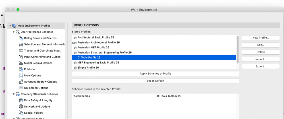

Hi There,
Can the CI cabinet tool be used in an education version of ArchiCAD? The coverings work ok but the cabinet tool isn't showing up under my design tools.
Thanks for your help.

You will probably be better off contacting Central Innovation about this.

Hi! I've just found a solution as I had the same issue as you. If you go to the Work Environment there should be a Ci Toolbar Profile - apply it. Should help!
