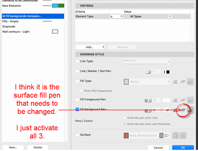

I tried this but it's not working for me. Maybe I have incorrect settings somewhere. See screen shots
Screen Shot 2021-10-21 at 11.40.24 AM.pngScreen Shot 2021-10-21 at 11.42.35 AM.pngScreen Shot 2021-10-21 at 11.41.27 AM.png

Solution
Try activating the 'surface' fill for the background pen.
Otherwise you are just trying to change the 'cut' background pen.
Barry, you're brilliant! That worked! Thanks
