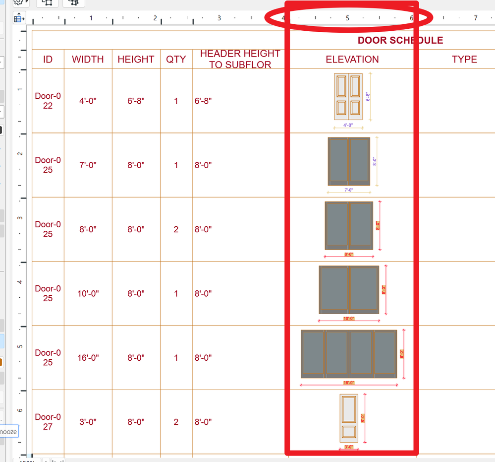

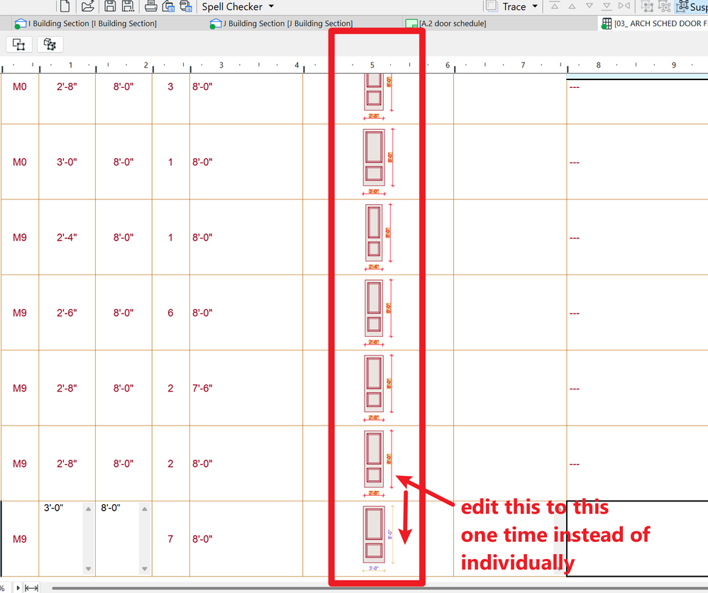

Window Schedule edit dimension pens for all door elevations entire row one time
Window Schedule edit dimension pens for all door elevations entire row (one time, opposed to having to do each door.) see attached snapshot: would like to change these dimensions pens for all doors, one time. opposed to each one individually.  How can I select the entire column?  second snapshot

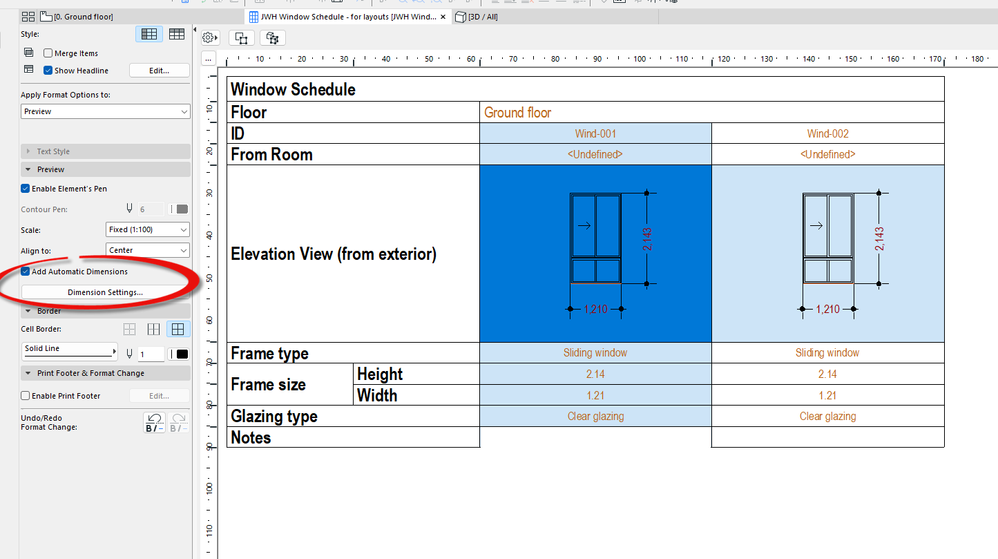

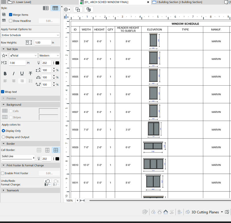

Thank you fo rthe information. I made it to step #5 but do not see: "Add Automatic Dimensions" checkbox on the Formatting panel of the left. Please see attached snapshot at bottom of screen of AC28 formatting panel
I am on AC28, is it different for AC29.

Select one of the window cells.
