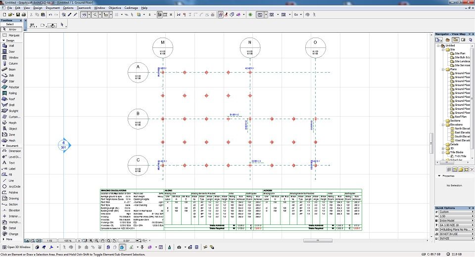

Thanks Danj I appreciate your help, I can see potential with this tool, it will be great if I can include all of the bracing.
Especially as the new Ezybrace calculator does not have subfloor bracing in it!

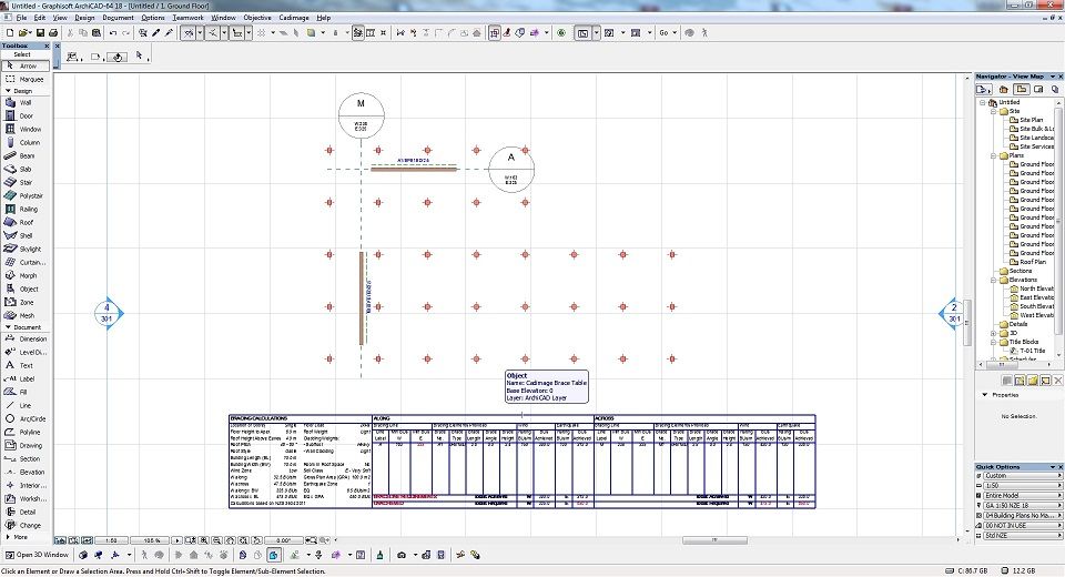

So you want to add the braces (Anchor Pile, etc) as a preset, remember to set it as a fixed Bu's and not Bu/m. Then on your pile plan you want to draw a random walls each way and generate your bracing, it will throw all sorts of error at you but ignore them, we are just after some brace lines, elements and the table.
You want to delete the walls and the braces, then go to your object tool and manually add your braces from your cadimage folder, selecting the desired brace type as required. For anchor piles you will need to add a brace twice, one for each direction. You also want to duplicate your brace lines out to suit making you update the number in the object to reflect how many braces you create. Then you want to select your table and go to your cadimage menu and update. Now within the table properties there is a drop down box near top "Location of Storey" you want to set this to foundation of One (assuming single story) and it will now display the correct values in your table. (I have checked these values against the branz bracing calculation sheets and had had no issues with accuracy, yet). Now with "Foundation" selected if you add more braces and update your will get an error but it will still do the maths, once complete you need to go back into the table and select "Foundation of One" again and it should all work again and you should end up with a page like picture below. I really hope this makes sense.
I have been trying something along these lines, the bit I cannot find how to do though is set the fixed B/u's. Is this done in the preset or the calculation?
Ok I found it in the preset
Thanks Danj

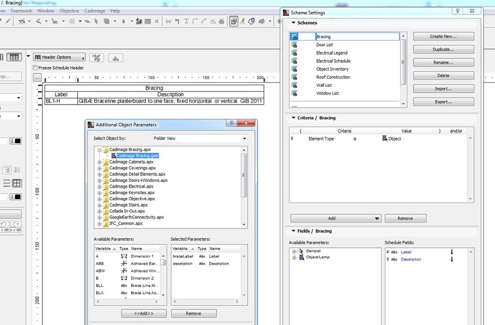

How do You schedule the descriptions?
Down the bottom in scheme setting click Add > Additional Object Properties and find Cadimage Bracing.gsm and add Label and Description
Hi Danj
I cannot get the table to work, when I replace the GS1-N braces for anchor piles from the object tool, then recalculate (changed to foundation of one) the table errors with insufficient bracing for all lines (doubled up) & appears with no bracing.
I can do a straight swap with the Gib braces for the anchor piles through the preset but then the table shows them as having a length.
I have set them to fixed BU's in the preset & then followed your instructions but I cannot get it to work.
Could you email me a plan file with a basic set up & the table with presets for this
Thanks
I have p'm ed you my email
