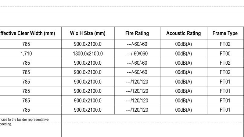

In my door schedule (AC11), the door size (WXH) values are obtained according to the size of the door itself.
In the schedule, I realized that it always displays the size in millimeters with one decimal place (Eg. 900.0 x 2100.0) when it really should read just 900 x 2100. At times it appears, and sometimes it chooses to go away.
Can somebody please tell me what controls the appearance/disappearance of the decimal place? I have a feeling that it has got something to do with my dimension/unit settings, but even that is quite strange.
I have attached a screen capture of a portion of my schedule illustrating the WXH column. Thank you very much.

Your working units should be millimeters without decimals. So should be the ones in the Dimensioning.

I found the problem and fixed it by checking the HIDE ZERO DECIMALS in the dimensioning settings.
