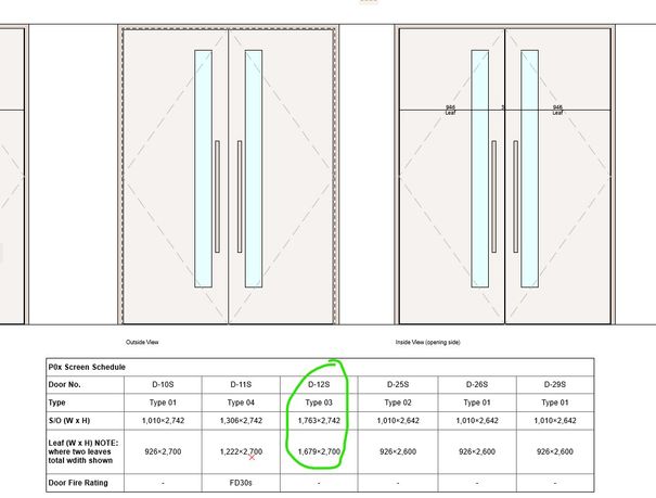

I have a double door in a schedule and have selected leaf dimensions. However, it gives a total combined size for the leaf's, not a separate size for each.
Is there a way to have a schedule show the individual leaf sizes?

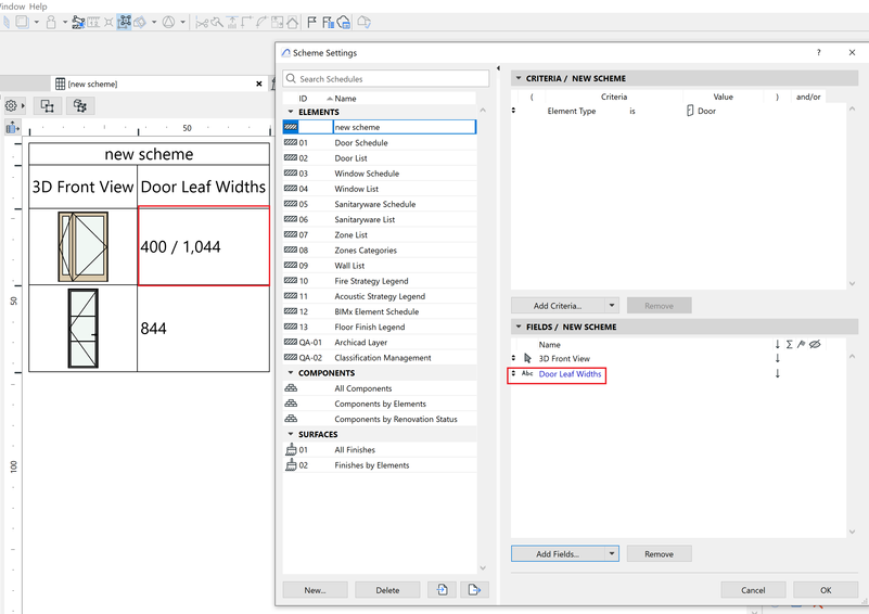

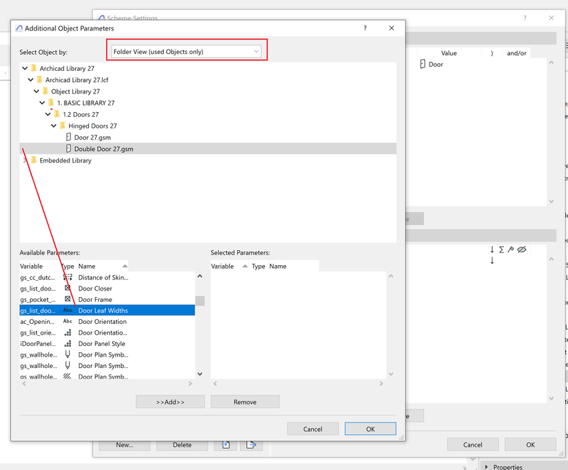

Does the Door Leaf Widths parameter help to achieve the desired result? To add it open the schedule followed by Scheme Settings (top right) next to the add fields button, click the black downwards arrow followed by Library Part Parameters and locate the parameter Door Leaf Widths, and use the >> Add >> button to add it as a new field:
Once added check the result in the schedule: (in this example I purposely set one door leaf of the Double Door quite small to show the different door leaf widths)
2026-05-28 10:38 AM
@Marcus Scott Thanks, this works.
Unfortunately, there is a flaw in that these sizes don't account for a gap between leaves, which is nominally 3mm. I imagine that's down to the model.
As you can't use the object parameters with expression, I don't see a workaround. Which, sadly, means I can't quite get a full schedule out of Archicad.
