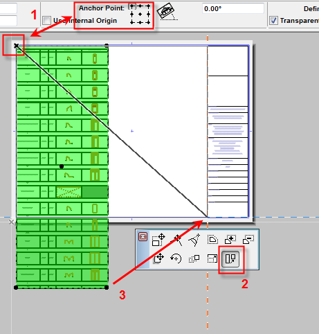

You have to use the Restructure Table command of the Pen Palette.
It is available only if the source of the Drawing placed on a Layout is a Schedule.
See the attached image for steps:
1. Select the Schedule Drawing and select the upper left corner for Anchor point. Then drag the Drawing so its upper left corner is at the upper left corner of the drawing frame on the Layout.
2. Select the Drawing and click the lower right node of it. From the appearing Pen Palette choose the rightmost button in the lower row of buttons. That is the Restructure Table button.
3. Now drag the lower right corner of the Drawing to the lower right corner of the Drawing Frame (or a bit higher to make sure the Drawing Title also fits onto the Layout).
The Schedule is recalculated and what was a long row will now become 2 or 3 rows of Schedule. You can play with the Row heights of the schedule (make them a bit smaller) to make sure 3 rows will fit.
In the attached image I have one long column so it will make it into 2 columns but it works the same way.
That's it.

You are welcome.
If your have a list that is very long then currently ArchiCAD is not smart enough to split it into several Layouts.
In this case what I would do is I would create two or three Interactive Schedule Scheme settings and introduce additional criteria, for example one of these Schemes would will all Doors on the first and second floor, the next: all Doors on the third and fourth floor etc.
The idea is to introduce enough criteria so that the largest Door Schedule will be small enough to fit on one Layout.
Of course, you can also increase the size of the Layout, if that is a possible option for you.
The other question: When you see the Schedule, you have the vertical panel on the left containing settings. At the top check the "Show uniform items as a single entry" checkbox to handle this problem.

Actually ArchiCAD 12 is able to split interactive schedules or project indexes (only ) over multiple layouts automatically.
You just need to restructure your schedule drawing, then enable 'Split Drawing among Multiple Layouts' in the Frame panel of the Drawing's settings.
This will show you tiled pages for the one layout and list the number of pages in the Navigator/Organizer. You can navigate between the pages using the 'Go to layout...' button or the 'Go to Previous/Next Layout' buttons at the bottom of the layout window.
Note that the tiled layouts shown in the layout window is indicative only. It will always show three layouts, no matter how many you really have.
