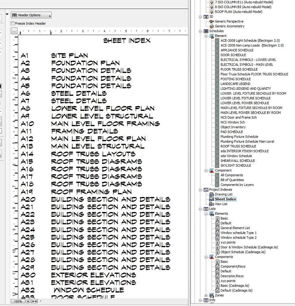

Try Project Indexes > Sheet Index instead of Drawing List
David
AC 19-26 Windows 10 64 bit, Dell Prercision 7820, Xeon Silver 2414R ( 12 Cores), 64 GB Ram, Quadro RTX 4000 8GB
Cheers David, but is there a way to make the drawing list not show the drawings i don't want?
Also when i created the sheet index only the layout name comes through, how do i get it to show the view windows on those layouts?
FYI im still very new to ArchiCAD
Place a view of the Sheet Index (from View Map, not Project Map) on your layout and crop out the bits you don't want. Just stretch the border with the pet palette.

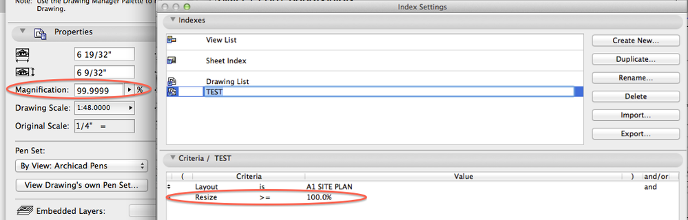

Here's a clunky work-around.
If all the drawings on your sheet are at least 100% magnification....
and a criteria to your list "resize is greater than or equal to 100%"
Then change the magnification of the items you don't want in your list to something smaller. i.e. 99.9999% It works in your case as they are not drawings that need to be to scale. Yes?
Make sense?
Marc Corney, Architect
Red Canoe Architecture, P. A.
Hahaha, cheers guys solves the problem for now, till I/you guys find a solution
once again thks for the help.
