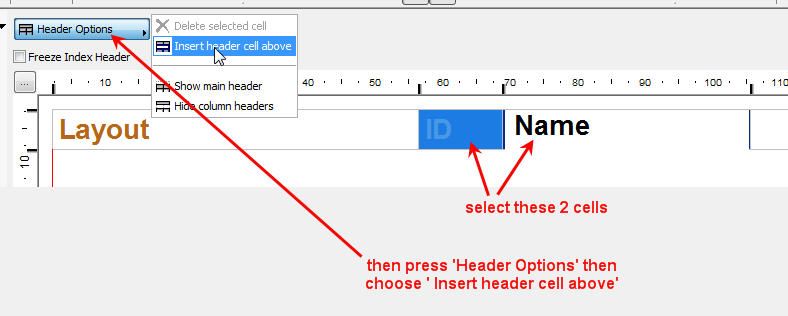

The othe little issue (apparently being reported to you guys in Hungary by a consultant from Graphisoft Australia) is how to have the headline with two rows in it.
In other words: see how the drawing list has ID and NAME in a row and DRAWING is above the both of them in its own cell? That's what the default ArchiCAD shows, however if you make changes and loose that setting, I'm not sure how to get it back.
In the layout list you can see how LAYOUT ID and LAYOUT NAME are in two separate cells next to each other. I can't group them and neither the Graphisoft consultant could.
Reason for wanting them grouped is obviously tidiness and saving of space in the table.

See attached image - that should explain it.
