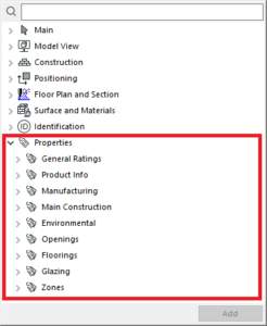

Communication between ARCHICAD Properties and IFC Properties:
IFC Properties can not be managed from the Property Manager, but ARCHICAD native Properties can be mapped to IFC Properties.
After the mapping, the Properties can be exported to IFC.

Level of Data:
ARCHICAD supports Properties of Element level (Wall, Slab, Beam, Zone...), but it doesn’t handle Project level (Terrain, Plot, Building...) and Component level data (Profiles, Composites). Building Materials have several hard coded Properties, but they can not be custom-created or managed as Element Properties.

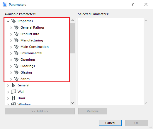

Element Classification:
Element Properties are distributed to Elements according to their Element Classification. This gives the user more freedom than relying only on Element Types. However, it also has some limitations. This Classification Sytem is based on the IFC 4.0 standard, it’s a flat, hard coded list without a hiyerarchy and cannot be further customized by the user. Whenever it is required to search for or schedule Elements of various Type, but similar purpose, we recommend to use Element Classification as criteria. However, unlike parameters, the list of available Fields or any further criteria will not be filtered according to the previously chosen Criteria. Since all properties are available for Fields, it is possible that some selected Fields will not be filled as they are not valid for the selected criteria. In this case the invalid value will be represented with an "---" symbol.

Hotlinked Modules:
Like other Attributes, Element Properties can be managed in the project where they were created. However, properties from Hotlinked Modules can be seen and scheduled in the target project as well. Hotlinked Properties that have the same name and group as any existing ones in the target project will be merged and scheduled together. In case they share the same name and group, but any other property data is different, you will get a notification, as long as the „show Hotlink conflicts” checkbox is active in the Property Manager. In this case you can solve conflicts by changing the definitions of Properties in the Host file to match those  in the module. If you do not resolve the conflict, then the property definitions of the host will prevail. Of course, you can always edit the Property definition in the Hotlinked Modules.
