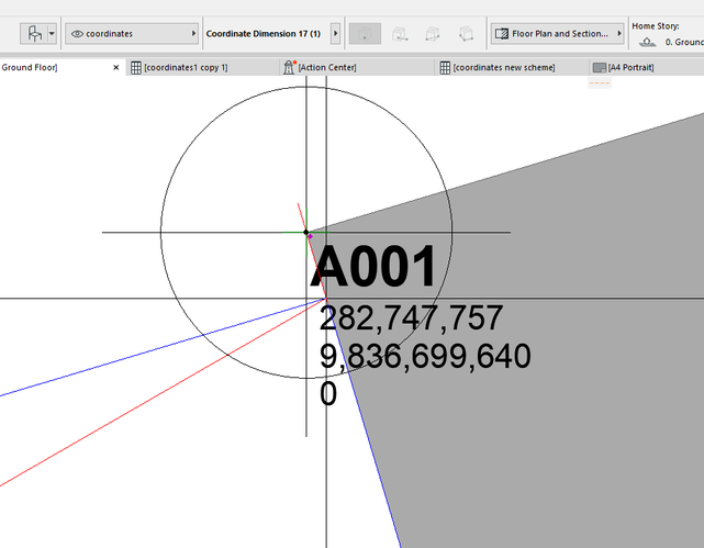

Hello guys, how can i go about exporting coordinate dimensions from archicad?
I cant seem to pull the same coordinates into a schedule in the first place like the photo shown below .
any help on how to export these to excel?

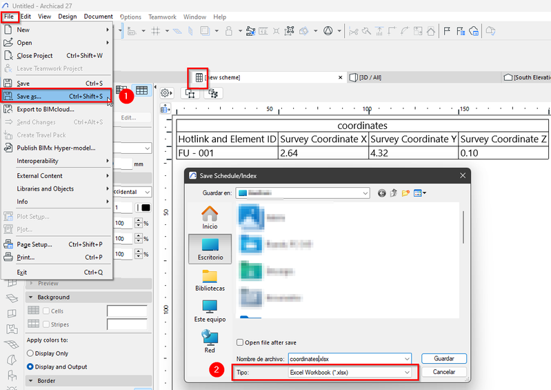

When you are in the schedule view you can File> Save as> Type> .xlsx

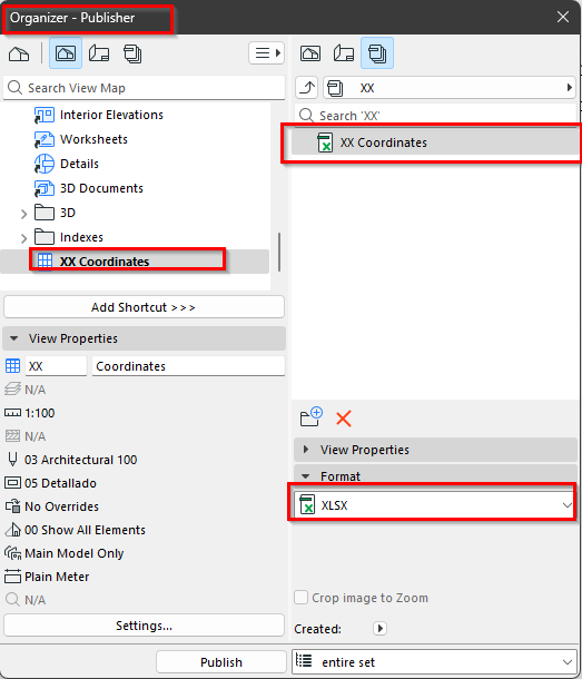

If you save that schedule view you can publish it directly as .xlsx too.
