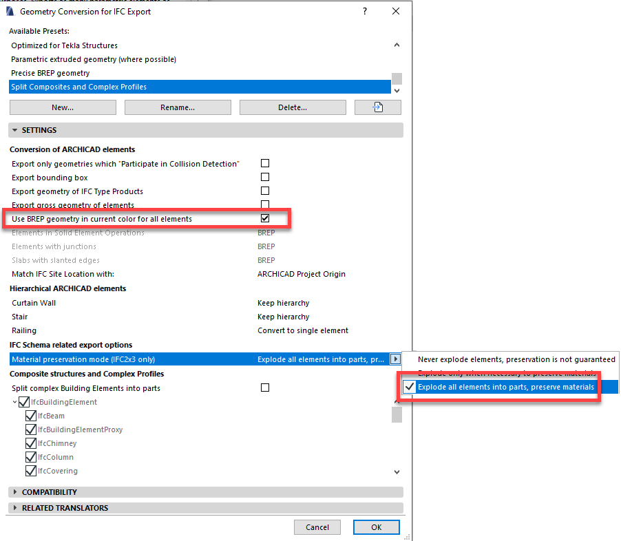

There is another way I could think up and I tested it and it works, although it takes several steps. The plus side of it is that you do not need to tamper with the settings in your Project. You will just have to play with IFC Export Settings.
This is for AC23. (In AC22, some IFC options are different and I have not tested those).
In the "IFC Translators" Dialog, go to the "Geometry Conversion for IFC Export" Dialog, and make sure that two options are set properly.
Option 1: the "Use BREP geometry in current color for all elements" checkbox should be checked.
Option 2: the "Material Preservation mode (IFC 2x3 only) fields should be set to the "Explode All elements into parts, preserve materials" option.
As you can see, the second option is IFC2x3-only.
So, if you save as IFC4, you can alternatively use the "Split Complex Building Element into parts" checkbox, and check the "IfcBeam", "IfcColumn", "IfcRoof", "IfcSlab", and "IfcWall" checkboxes, because these are the 5 element types that can have a Composite Structure or a Complex Profile. You can use this as an alternate for Option 2 in case of IFC 2x3 as well.
