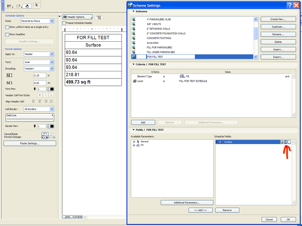

I am looking to see if there is a way to sum like fills in a schedule.
I know how to create the schedule to show the areas of each fill, but not sure how to ask the schedule to sum and give a grand total per floor.
Another problem is I need to sum same types with different areas in to a grand total and show in the schedule.

Yes. You can make a schedule for the area of your fills the same way you make any other schedule.
