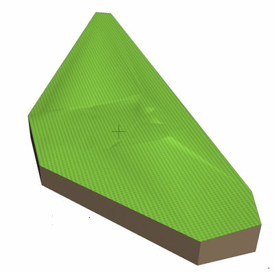

Hi Steve,
Sounds like you have got the text file format sorted now.
Here is the one I created from your 4 points (2 points are very close to each other.
Just with the default Windows Notebook text editor.
I don't think it matters what order the points are in so long as each point has an X, Y & Z coordinate separated by TAB.
The converter add-on will create a mesh and triangulate all of the points.
Be sure to select the correct surveyors unit as you import it.

Steve,
Use "Place mesh from surveyor's data" command.  You'll get what Barry showed in his screenshot.  This isn't a point cloud.

svpribyl
Hi Karl, 
Here's the series of steps that I had to take to get this to work on a Mac, in case anyone else is struggling with it:
1. Open surveyor's file (It was labeled .xyz, but it opened in Numbers
2. Copy relevant data by dragging to select and copying
3. Paste into TextEdit using CMD-Option-Shift-V (This is supposed to just paste the data, but I'm not sure if it worked, based on step 6.
4. Change TextEdit file to .txt in the "Get Info" box
5. Open the TextEdit file
6. Delete this misc text at the top, above the three columns of data and the slash at the end of each row, and the } at the end of the data
7. In Plan view, use the Interoperability -> Place Mesh from Surveyor's Data command
A piece of cake... Ha!
Thank you for your help!
