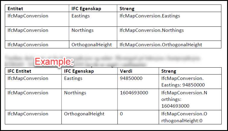

My client want IFC4, georeferenced whith the information embedded in the IFC-file, like this

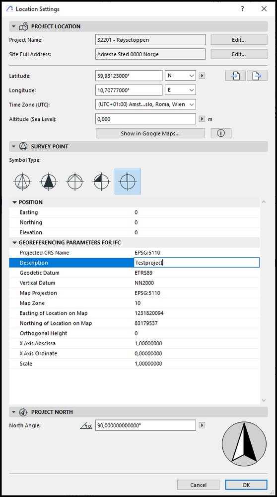

I believe this is where I have to fill in the data to make this work:

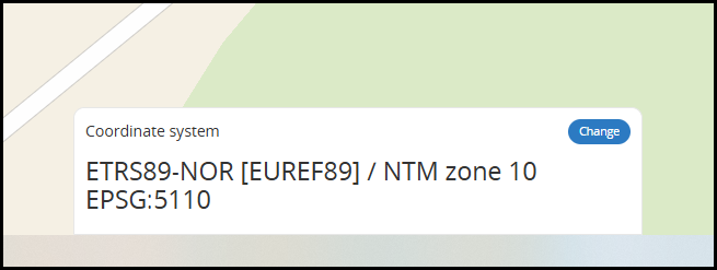

I have filled in all the information requered, (I believe), supplied by EPSG.IO:

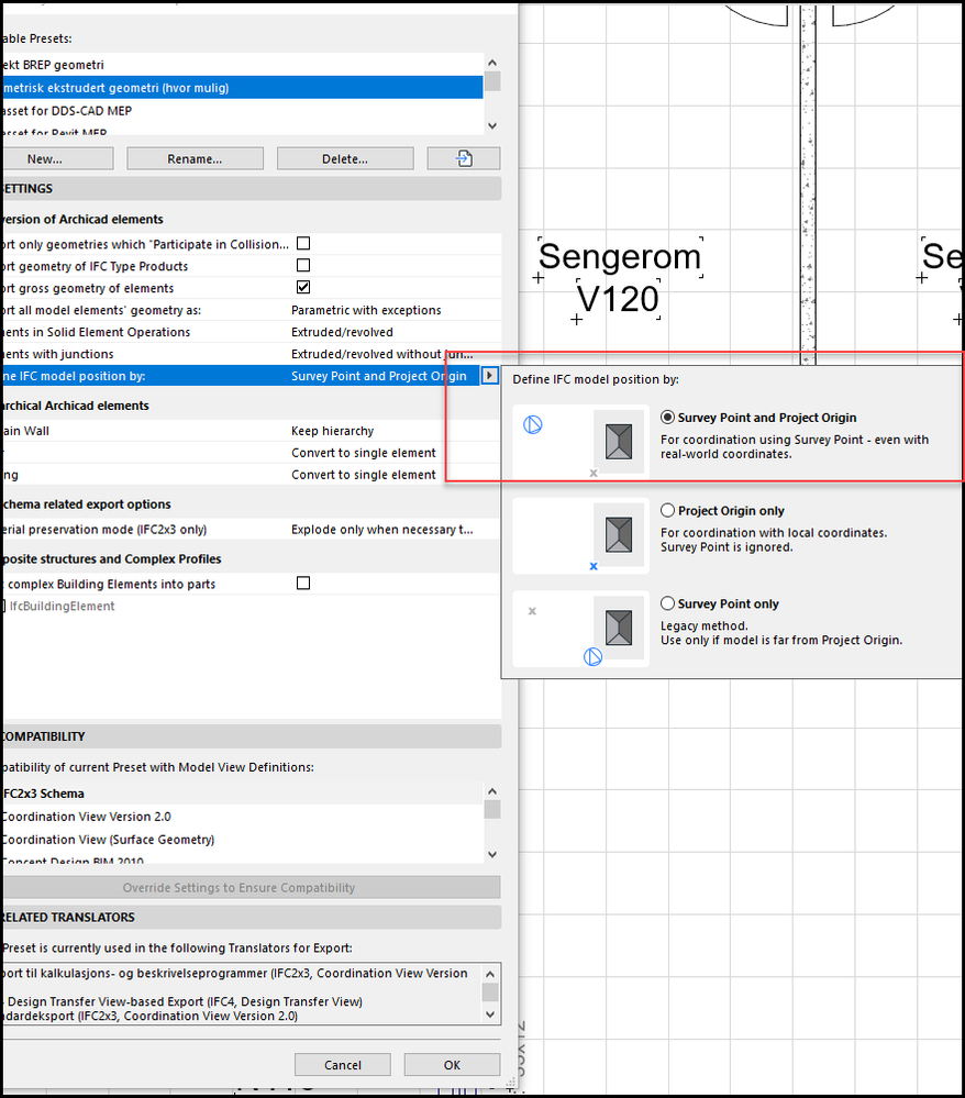

I have also made sure that the IFC-exporter is correct:
Still, when I export to IFC, this is the only instance of IFCMAPCONVERSION in the file when opened in notepad...

I discovered, like you are pointing out, that everything is done correct.
I just had to take the IFC into solibri to confirm that everything was in place!

I think you’re doing everything right. There should be only one IfcMapConversion entity, because the different properties (egenskaper) are just different attributes of that one entity. As you can see, the easting is the third attribute, the northing is the fourth, and the elevation is the fifth in the IFC file.

For EPSG codes, https://epsg.org is a very useful reference. For example, the details of your code (5110 – ETRS89 / NOR EUREF89 NTM zone 10) can be found here:
https://epsg.org/crs_5110/ETRS89-NOR-EUREF89-NTM-zone-10.html
