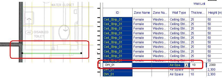

Help!How to show the zone name of the wall inside it?
I palce the wall around the zone. The zone name of the wall inside the wall schedule list is OK. When the walls is placed inside the zone, the zone name of the wall inside the wall schedule disappear.
I tried to change " relation to zones "/ "Listing and Labelling "/"Wall Selection Settings" . However the zone name is still invisible inside the wall list.
Any idea for showing the zone name when the walls are inside the zones?
1 REPLY 1
Hello,
The doors and windows have the same problem -
they only know the zone if the wall they are placed has a
common side/edge with the zone edge. Doors/windows
placed inside a zone have no clue about the underlying
zone.
