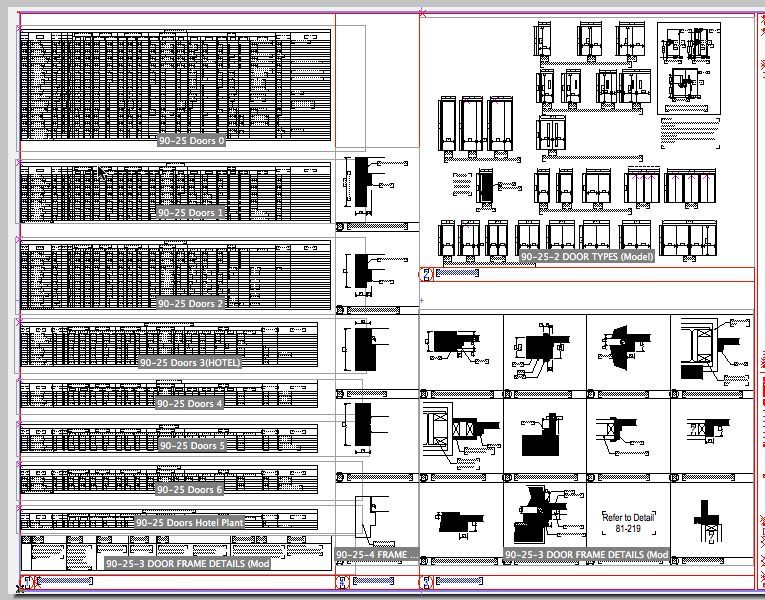

unless they are on different stories? you could set up two schedules, each with a 'by story' criteria . . . ? any good?
~/archiben

'by story' door schedule - plotmaker layout...........
schedules created with IS, details in detail windows . . . same same, but different.
~/archiben
