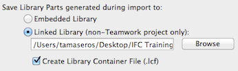

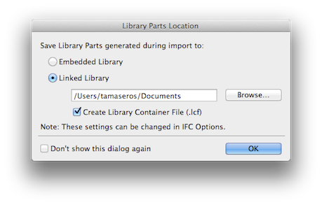

IFC Import Populates Embedded Library
Issue
IFC import can populate the embedded library. This behavior can lead to very large embedded libraries and possible performance problems.
wp-content_uploads_archicadwiki_ifc-troubleshooting-ifcandembeddedlibrary--ifcembeddedlibrary_80.png
Solution
ARCHICAD 18 and newer
When you import an IFC file ARCHICAD 18 will ask where you would like to place the objects to be created. Select Linked Library and define a path. It is suggested to compress the library into a Library Container File (.lcf).
If you have selected not to show this dialog again, you can change these IFC library settings in IFC Options (File menu/File Special/IFC 2x3/)

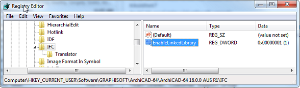

ARCHICAD 16
This new behavior was introduced with ARCHICAD 16 Hotfix 3 build 3480. To activate it the EnableLinkedLibrary key needs to be added to the Registry under the IFC registry folder. On a Mac a new key with a Boolean type needs to be added with its value set to “True.” The below example shows this key on Windows. (with an Australian ARCHICAD version).
wp-content_uploads_archicadwiki_ifc-troubleshooting-ifcandembeddedlibrary--ifcregistryenabled_80.png
If the IFC folder is not present this generally means you haven’t yet run an IFC import on your computer. Navigate in an open instance of ARCHICAD 16 to File / File Special / IFC 2x3 / IFC Translation Setup and press save [Save Settings & Close] button.

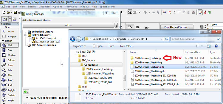

Workflow suggestions
After activating this behavior your IFC imports will not populate the embedded library with objects. Instead a folder named after the IFC file and located on the given path (17 and 18) or in the same directory as the source IFC file (16) will be created, unless this folder already exists. Within this folder a folder will be created based on the date and time in seconds that the import took place. This folder will be automatically linked to the imported project. In the below example a file called “2020Sherman_WestWing.ifc” was imported. Since this was the first time a project of that name was imported a new folder “2020Sherman_WestWing” was created. Under the “2020Sherman_WestWing” folder another folder was created. It was named 20130103_154222_000 and linked to the imported file. The 20130103_154222_000 folder contains all of the library objects generated in this import.
wp-content_uploads_archicadwiki_ifc-troubleshooting-ifcandembeddedlibrary--ifcfirstimport_80.png
The second time an IFC file is imported with the same name only the sub-folder 20130103_160343_000 is created to store the new objects. This is a nice way of keeping your imports sorted.
wp-content_uploads_archicadwiki_ifc-troubleshooting-ifcandembeddedlibrary--ifcsecondimportlibrary_80.png
A new IFC file name will create a new folder and link. Thus your IFC libraries can be clearly organized using the name of the IFC file that created them and then further organized by the time the IFC file was imported.
wp-content_uploads_archicadwiki_ifc-troubleshooting-ifcandembeddedlibrary--ifceastwingimport_80.png

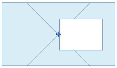

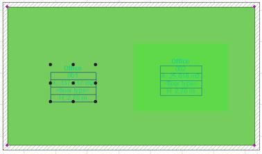

Overlapping Zones create hole in Revit
Issue: When opening an IFC file in Revit, only one zone with a hole is visible instead of two zones .
Cause: Two zones were created in ARCHICAD on each other. Saving the file as IFC and opening it in Revit gives different result. Revit does not support overlapping zones.

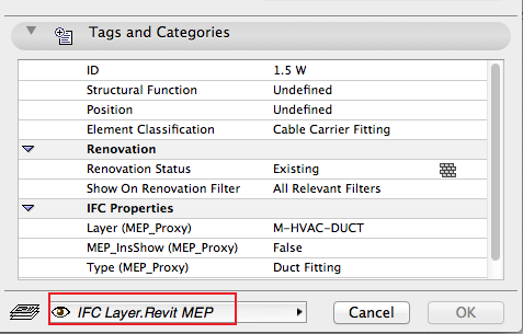

Layer management problem for IFCs coming from Revit MEP Add-In
Affected version: 16 and earlier| Severity: no workaround applicable | ID: 129649
NOTE: This issue was fixed in ARCHICAD 15 Hotfix 4.
Issue: When opening/merging IFC files from Revit saved with the help of the Revit MEP Add-In: Even though the option 'Imported layers with extension' was used everything will be set to the IFCLayer.extension.
Cause: The layer information is not considered in case the IFC file comes from Revit MEP.
Solution: This bug will be eliminated in the next Revit MEP Add-In.
Note that this affects only IFC files saved with Revit MEP Add-In.

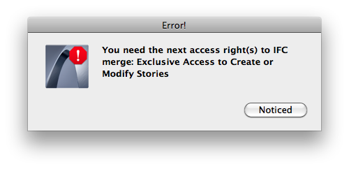

Cannot merge IFC model into a TeamWork project
Affected version: 15 | Severity: workaround applicable | ID: 129190, 130286
NOTE: This issue was fixed in ARCHICAD 16 Release version. The program gives 'You need the next access right(s) to IFC: Exlusive Access to Create or Modify Stories' error message while merging the model even the current user has team leader role (with all rights).
By reserving the story settings the right(s) can be guaranteed.
