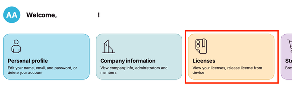

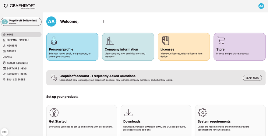

Once you have purchased your cloud license you can review and manage it on https://graphisoftid.graphisoft.com. sign in with your Graphisoft ID where you can manage your personal profile, check your company information, and get information about the licenses that are available to you.
Please note that, regardless of the product in question, you need to assign a license to your Graphisoft ID even if you purchased one on behalf of your account.

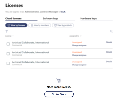

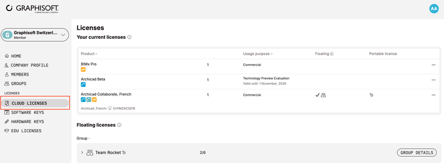

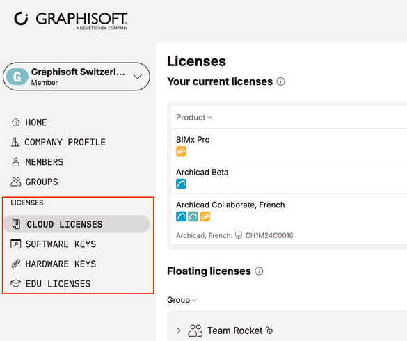

Select the Licenses option to review your cloud license.
On the Licenses page you will see your currently available licenses and some basic information, such as company information and company admin information. Select the Cloud license option to review the  cloud licenses available to you.
You can filter your licenses by 3 different views:
  • View by licenses – displays all available licenses in the order of purchase.
  • View by members – displays all available licenses grouped by current assignees.
  • View by products – displays all of your licenses based on the available products defined by your subscription.

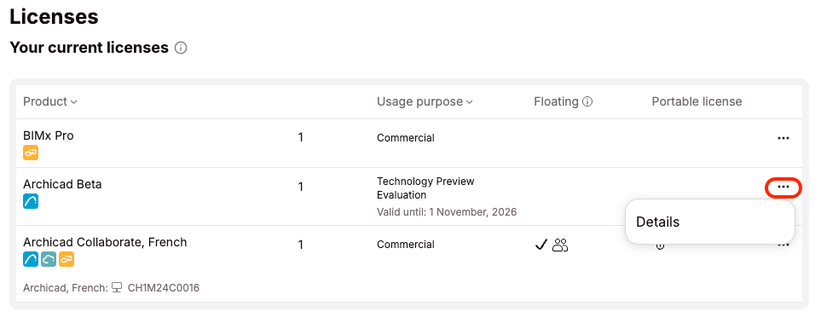

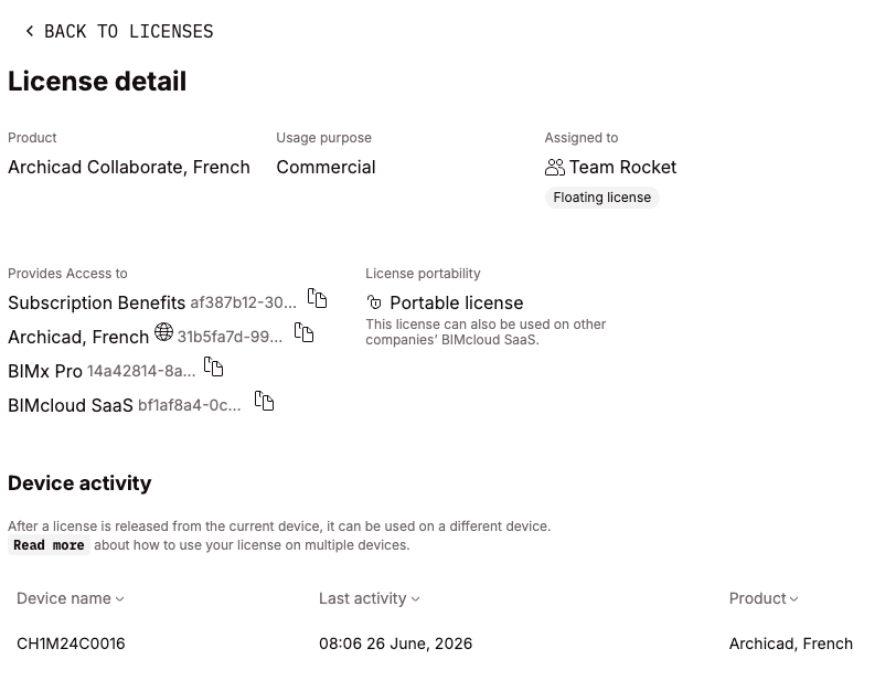

You can access even more information about your cloud license on the Details page. Depending on your subscription, you will get access to the following products and services:

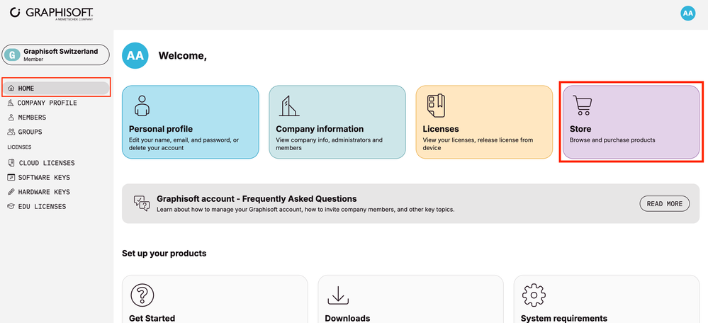

For more details about the available subscription options in your region, please visit our Graphisoft Store.
Need more licenses? Click on ‘Go to Store’ and purchase as many additional subscriptions as you need. Your newly purchased licenses will be available within a few minutes on the License Management portal.

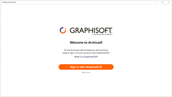

You can activate your cloud license for Archicad by signing in with your Graphisoft ID. Make sure you enter your credentials correctly and have a stable internet connection.
Enter your username and password and sign in. That’s it!
NOTE: once you have activated your cloud license, it can be used for an unlimited amount of time as long as you have internet connection. If you need to use Archicad offline, no worries, the license includes 7 days of offline usage. After 7 days you might need to verify your license validity, which requires an internet connection again.

You can use your cloud license on only one computer at a time, but thanks to a feature of the cloud license, your license can be virtually released from one computer and activated on another one over the internet.
Visit https://graphisoftid.graphisoft.com and sign in with your Graphisoft ID account. Under the Licenses menu’s Cloud license page, you can see where your license is currently being used. Click on the ‘Release from device’ button to release your license from its current device.
Select ‘Release license’ to complete the process. Please note that if Archicad is still running on the first computer when you release the license, a message will prompt you to save your project, because the license for this computer is no longer available. Make sure you save your changes before you switch devices to prevent data loss.
