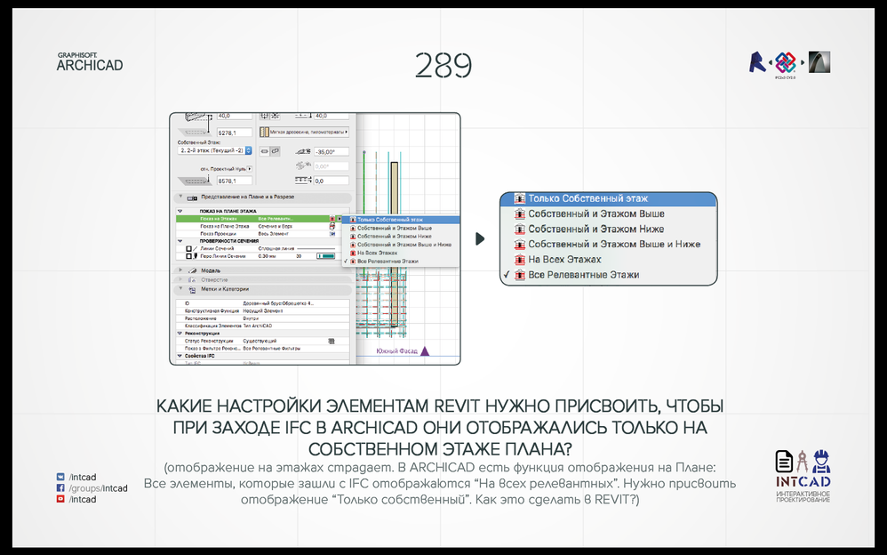

289. What settings item we need want to assign on REVIT to entry IFC in ARCHICAD they are displayed only on its own floor plan?
(Display on the floor suffering in ARCHICAD a function display on the Plan.:
All the elements that are displayed with the IFC's gone "on all relevant". It is necessary to assign the display "Only their own". How to do it in the REVIT?)
Where I can get this IFC parameter?
There is no such IFC parameter/entity.
You can, potentially, create a custom IFC property for bi-derectional exchange, if you need to identify such elements on import, but a simple Find&Select routine based on layers or any other identification principle would work too (after import to ArchiCAD).
yes this is exactly what we need. How to do it? Maybe, you have a tutorial movie on this issue?
What is wrong with ArchiCAD manual? Seems to be a valid resource.
Interoperability > File Handling and Exchange > Working with IFC > Working with IFC Data > Creating and Editing IFC Data
However, I don't think you need that in your case. I would simply use Find&Select after import and change that attribute for any element I need. Keeps IFC file cleaner this way.
