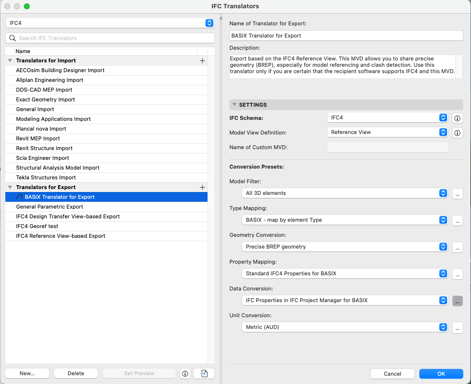

I am exporting several zones as ifcSpace
some spaces are landscape types, residential bedrooms, toilets, dining etc
how do I specify ifcSpaceTypes to catch all zones of type BEDROOM or all zones of type VEGETATION,
at present I can specify a Translator that ends up making all zones predefinedType BEDROOM with no other differentiation
tia
Operating system used: Mac Apple Silicon 15.6 (24G84)

Hi Stefan
here is my Translator  IFC types for export settings
this causes all ifcSpaces to be of pdt = BEDROOM, eg
#640=IFCSPACE('1WdIHRts6bG9Vv5YLpOG4G',#2,'R03',$,$,#2030,#149,'Bathroom',.ELEMENT.,.INTERNAL.,$);
#727=IFCSPACE('0O$C6NAS1jHgbErheaa5ym',#2,'R01',$,$,#2675,#163,'Kitchen',.ELEMENT.,.INTERNAL.,$);
#730=IFCSPACE('2s$tiOQgoFIB7tQ$SZTMFg',#2,'R02',$,$,#2690,#165,'Living/Dining',.ELEMENT.,.INTERNAL.,$);
#19557=IFCSPACETYPE('07H_kqEGBtKlnXmYKpVV4j',#2,'Garden',$,$,$,$,'0747EBB4-3902-F752-FC61-C225337DF12D','BEDROOM',.USERDEFINED.,$);
#19645=IFCSPACETYPE('3LH2SGTg8K88W9ZSbyzjmU',#2,'Lawn',$,$,$,'D5442710-76A2-1420-8809-8DC97CF6DC1E','BEDROOM',.USERDEFINED.,$);
#19778=IFCSPACETYPE('0P3RcR$3cAZ81JH4bxcyYw',#2,'RESIDENTIAL GARAGE',$,$,$,$,'190DB99B-FC39-8A8C-8053-44497B9BC8BA','BEDROOM',.USERDEFINED.,$);
So, I'm unclear how to for example for all rooms in a residence specify any bedroom to be type "BEDROOM", any toilet, bathroom, shower type "SANITARY", etc. Hospitals have such classifications.

tks for all the feedback.
I have 3 "types" of spaces - external for vegetation water usage types, internal rooms and internal rooms of type "BEDROOM". I customised each (following your suggestions) and here are the settings in my Translator
and here is the IFC
#10565=IFCSPACE('3XSu3jajIWJOVDoaxdS8wW',#2,'R04',$,'BEDROOM',#95955,#877,'Bedroom',.ELEMENT.,.USERDEFINED.,$);

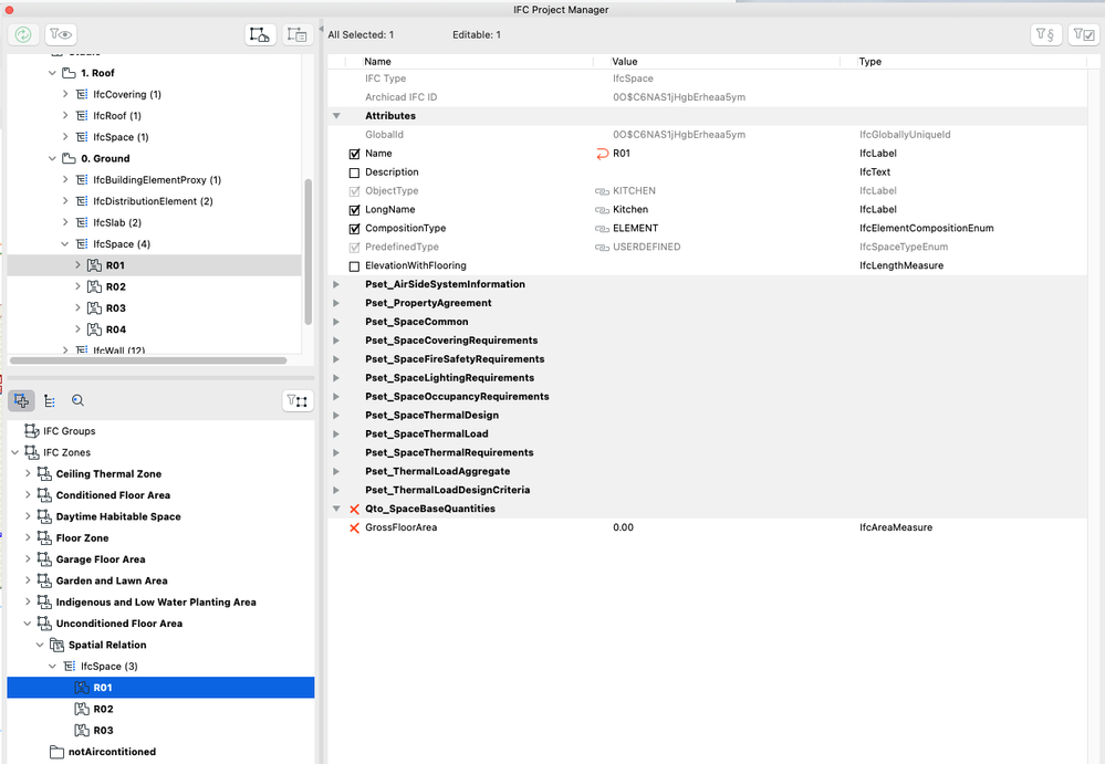

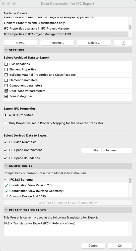

Another issue are the Base Quantities export.
In the Translator I have set my export translator as the Preview.
Does this now mean I can see in the IFC Project Manager the values of these quantities?
Not showing at present...
