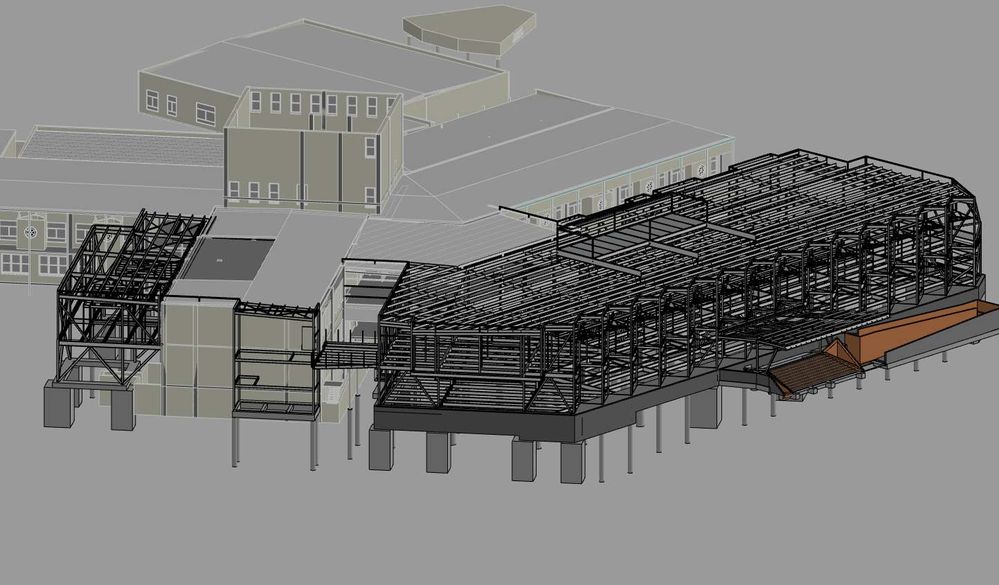

Matthew,
I have had similar problems with Revit beams, columns and slabs that have cuts being imported as objects rather that beams and columns, with angled bracing being especially problematic.
My solution to the problem is to have a structural model (controlled by me) which I hotlink into the main project file. This file started as an imported file from revit and I went through the file and replaced the imported members that were blocks with beams and columns. When I now receive an updated structural model I reference this into the structural model and make required adjustments where the model differs from my model.
By doing this I have a model that is quick to navigate and section generation times are minimal.
Attached are a couple of views from my current project, I can navigate views in real time and sections and elevations only take a few seconds to regenerate.
Regards,
Scott

As Laszlo has indicated, if the revit export has exported a primitive object with lots of polygon faces, it's difficult to reverse engineer the intelligent object back out from it.
The Revit IFC exporter is openSource, so it might be possible to "improve" the export with a sample object to test with. I've been developing an IFC importer for Revit including IFC4 (http://geometrygym.blogspot.com/search/label/IFC) and I am also trying to get a chance to start working on an independent exporter too.
It should not be necessary to manually substitute objects each time a model is submitted, but certainly in this case (and Scott's by the sound) a higher quality IFC export would go a long way to help this.
