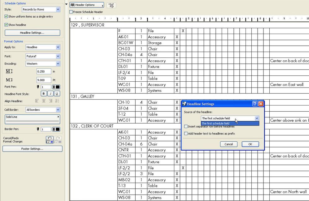

When I originally set up this IS, I wanted the first three schedule fields to appear in the headlines -- I think I did this via Headline Settings... -- I have since eliminated schedule field three, and want to use the first two schedule fields as a headline. When I revisit Headline Settings... I am only given the option to use "The first schedule field", which does nothing. Once one merges more than one field into a headline, can that not be redefined? Am I going to have to recreate my IS?

Barry wrote:
Could you please show us an image of your new schedule so we can see how you want the headings and can compare to your first image?
Here is a screen shot of the re-created IS, along with the limited options within the Headline Settings dialog.

Here is a screen shot of a brand-new IS -- note the multiple options in the Headline Settings. I can't figure out at what point the options become limited -- I've tried Sending & Receiving and rebooting AC, but I still have multiple options in the brand-new IS, but limited options in the IS I created yesterday. I have not tried shutting down completely, maybe when I have the time...
Thank you Laura.
I thought you could only use the first field as the headline.
I can see a use for this already.
Laura wrote:
I can't figure out at what point the options become limited...
I can't be of much help here.
The only time I have just the option for the first field is if a schedule only has 2 fields in total - which is obviously not the case with your schedule.
