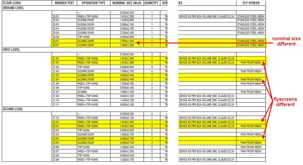

Not this time. We have two windows which are exactly the same, copied properties, inserted in the same wall with the same specs, including the renovation filter ones, however in the schedule they are separated as opposed to be grouped. Actually, in one case we have 6 identical windows, 5 are shown together, one is on its own.
Any idea where to what we can look at?

In all your testing is it always the same window which separates itself? The most common reason I have found for this is differing wall thicknesses, but you say in your first post that they are in the same wall so that is not it. Are you using standard AC windows / Schedules or Cadimage windows?
I just tried mirroring a window but they still list as one (so long as I am not scheduling the handing).
Are you using the ID in your schedule and if so are the IDs identical? - it could even be just an extra space at the end of the ID.
But you say you have copied windows so I don't think that is the case.
If that is not it can you show a screen shot of the schedule?

we just tried to copy the window and it appears correct in the schedule (grouped), but if we copy the properties with the eye dropper and create a new window the schedule puts it in a separate line.
Attached schedule and schedule settings as requested.
Windows that are playing up are Z1.01 and Z1.04 on level one and Z2.01 and 2.04 on level two (they are the same windows on two different levels)

The schedule you show does have differences meaning they won't group.
The sliding doors on ground level (Z0.07) are different sizes.
All the others with the same ID on the other levels have different flyscreens which is stopping the from grouping.
Are the ones I have highlighted the ones that you think should be grouping?
I need to get our contractor to check that it's correct but I believe it is!
Time to go to the optometrist!
Can this thread be deleted to avoid any further embarrassment?
